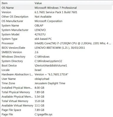

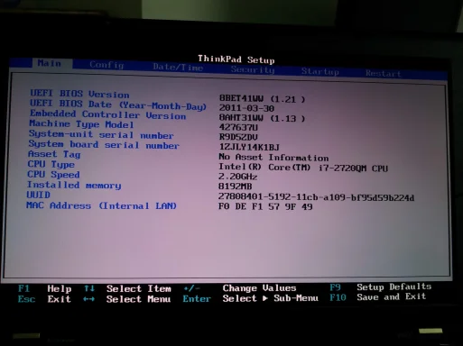

Hi,
What do you mean BIOS memory configuration?
this is my BIOS and systemInformation?
What else do you need?
Thanks,
