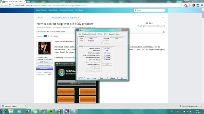

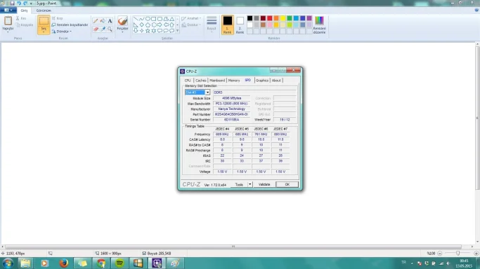

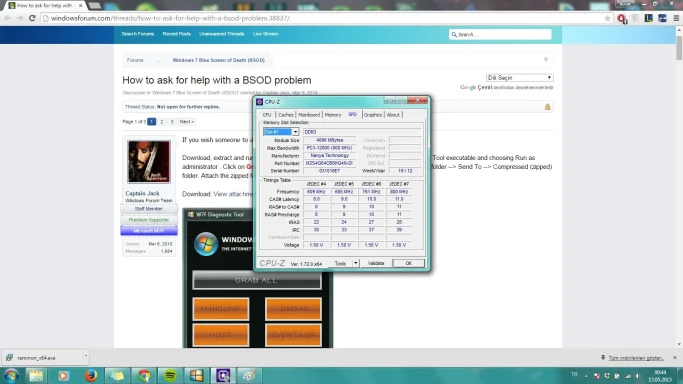

I checked my rams with memtest86. But it found nothing.
I uploaded CPU-Z tabs

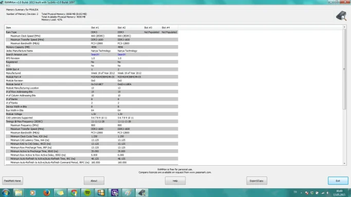

Rammon:
RAMMon v1.0 Build: 1015 built with SysInfo v1.0 Build: 1097
PassMark (R) Software
Memory Summary For FRAUDA
Number of Memory Devices: 2 Total Physical Memory: 8088 MB (8192 MB)
Total Available Physical Memory: 4674 MB
Memory Load: 42%
Item Slot #1 Slot #2 Slot #3 Slot #4
Ram Type DDR3 DDR3 Not Populated Not Populated
Maximum Clock Speed (MHz) 800 (JEDEC) 800 (JEDEC)
Maximum Transfer Speed (MHz) DDR3-1600 DDR3-1600
Maximum Bandwidth (MB/s) PC3-12800 PC3-12800
Memory Capacity (MB) 4096 4096
Jedec Manufacture Name Nanya Technology Nanya Technology
Search Amazon Search! Search!
SPD Revision 1.0 1.0
Registered No No
ECC No No
DIMM Slot # 1 2
Manufactured Week 19 of Year 2012 Week 19 of Year 2012
Module Part # M2S4G64CB8HG4N-DI M2S4G64CB8HG4N-DI
Module Revision 0x0 0x0
Module Serial # 0x31018E7 0x6D1118EA
Module Manufacturing Location 13 13
# of Row Addressing Bits 15 15
# of Column Addressing Bits 10 10
# of Banks 8 8
# of Ranks 2 2
Device Width in Bits 8 8
Bus Width in Bits 64 64
Module Voltage 1.5V 1.5V
CAS Latencies Supported 5 6 7 8 9 10 11 5 6 7 8 9 10 11
Timings @ Max Frequency (JEDEC) 11-11-11-28 11-11-11-28
Maximum frequency (MHz) 800 800
Minimum Clock Cycle Time, tCK (ns) 1.250 1.250
Minimum CAS Latency Time, tAA (ns) 13.125 13.125
Minimum RAS to CAS Delay, tRCD (ns) 13.125 13.125
Minimum Row Precharge Time, tRP (ns) 13.125 13.125
Minimum Active to Precharge Time, tRAS (ns) 35.000 35.000
Minimum Row Active to Row Active Delay, tRRD (ns) 6.000 6.000
Minimum Auto-Refresh to Active/Auto-Refresh Time, tRC (ns) 48.125 48.125
Minimum Auto-Refresh to Active/Auto-Refresh Command Period, tRFC (ns) 160.000 160.000
DDR3 Specific SPD Attributes
Write Recovery Time, tWR (ns) 15.000 15.000
Internal Write to Read Command Delay, tWTR (ns) 7.500 7.500
Internal Read to Precharge Command Delay, tRTP (ns) 7.500 7.500
Minimum Four Activate Window Delay, tFAW (ns) 30.000 30.000
RZQ / 6 Supported Yes Yes
RZQ / 7 Supported Yes Yes
DLL-Off Mode Supported Yes Yes
Maximum Operating Temperature Range (C) 0-95 0-95
Refresh Rate at Extended Operating Temperature Range 2X 2X
Auto-self Refresh Supported Yes Yes
On-die Thermal Sensor Readout Supported No No
Partial Array Self Refresh Supported No No
Thermal Sensor Present No No
Non-standard SDRAM Type Standard Monolithic Standard Monolithic
Module Type SO-DIMM SO-DIMM
Module Height (mm) 30 30
Module Thickness (front), (mm) 2 2
Module Thickness (back), (mm) 2 2
Module Width (mm) 67.6 67.6
Reference Raw Card Used Raw Card F Rev. 2 Raw Card F Rev. 2
DRAM Manufacture Nanya Technology Nanya Technology
