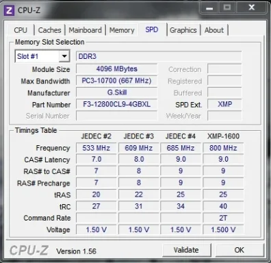

Your memory is set wrong: currently 1080Mhz 7-7-7-20 while rated 1600Mhz 9-9-9-24 1.5v. Adjust the DRAM options in the bios, save and reboot.
Thanks for the quick reply. I've updated my ram timings to 9-9-9-24.
Link Removed
As for safe mode, I have not been able to replicate the problem in safe mode.
The frequency is still 1080Mhz - compare it with the manufacturer's specs.
Right now I'm unsure if I am doing this correctly. I have the ram at 9-9-9-24 still. The Dram voltage is at 1.5. I then proceeded to change the system memory multiplier from auto to 12 in order to get the frequency at 1600. After doing this, indicator lights on my motherboard came on indicating slight over voltages of the cpu, ram, and north bridge. I then tried turning on the xmp profile settings with the same results. Is this normal, or is there something I should change?
Load setup defaults in the bios and enable XMP profile, save and reboot.
If still wrong, address this issue at the RAM maker's forum.
