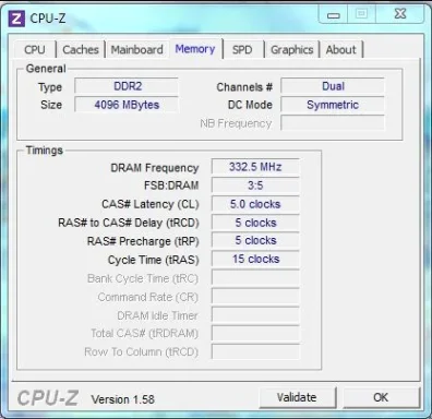

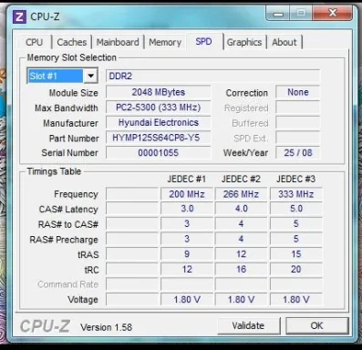

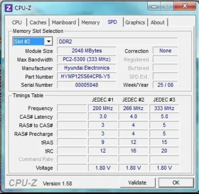

Download and run CPU-Z. Take screenshots/snips of the Memory tab and all the slot#'s under the SPD tab.
Go to Post Reply, click on the Go Advanced button and attach the screenshots/snips to your post for all the RAM experts to see by using the paper clip you will find on the top toolbar. Do not zip them up.

#3
Hi Elmer,
Thanks a lot for your help.
I have done all of the prioritary things you mentionned. Unfortunately, my laptop was built with windows vista and the Manufacturer is not updating the drivers to windws 7 (i know it's silly!)
I have been looking about to find some updated drivers but without success maybe you could help.
it's a XPS m1530
I have also attached all the screenshots and reports you said would help.
I hope someone out there will have some time to look at those.
View attachment CPU-Z SPD-2.zip
Thanks a lot
