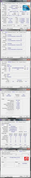

Hey guys! I am a college student who knows almost nothing about computers. Please help me out. This might be a bit long, but please bear with me.
Last month, I had a dell technician come to replace my casing (this is a laptop). Since then, every time I move my screen up and down, I would hear the usb beep. Its the same sound as if Im plugging in and removing a usb device. My theory is that the technician didnt insert the webcam back into the casing correctly, because Ive isolated the sound to the webcam (when the sound happens, the webcam would disconnect briefly). Ive also started getting BSODs frequently, at least once a day if I move the laptop. Its usually a bugcode_usb_driver bsod. My question is is this a hardware problem or software? If hardware, which part is it? If software, how can I fix this? It gets very annoying as I have to save homework and papers like a paranoid in fear that itll bsod on me. Thanks in advance!
Attached is the last dmp file (File name: 033112-22245-01.rar) and cpu-z pictures.
edit: My laptop just crashed again. This time there wasnt a bsod (very unusual). Im attaching that too, in case it can help (file name: 040512-20857-01.rar).

Hi triload and Welcome to The Forum.
I'm not sure any of this is going to help you as it sounds like its a hardware issue. But some things to try, apart from getting Dell out again to fix it up properly.
STOP 0x000000FE: BUGCODE_USB_DRIVER
Usual causes:
USB device driver
Your latest dump file lists usbhub.sys as the probable cause.
This is a Windows System file and for it to be the cause of your crash is highly unlikely.
Old and incompatible drivers can and do cause issues with Windows 7, often giving false error codes.
Random stop codes can often indicate hardware issues.
As a Priority:
dtsoftbus01.sys Mon Oct 17 13:12:30 2011 The dtsoftbus01.sys driver has been known to cause problems on some Windows 7...
