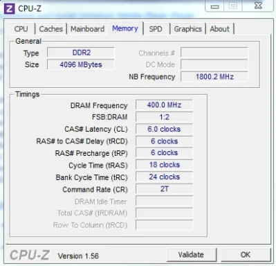

    Been BSOD after upgrading from vista to windows 7
    The BSOD is very random sometime the system runs fine and sometime it just BSOD alot
    I am using a laptop and the model is:
    HP- DV5-1114AX
    I would be very thankful if anyone can help me out.
    i have attach some files
