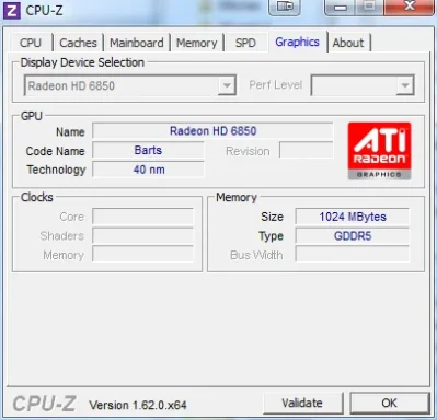

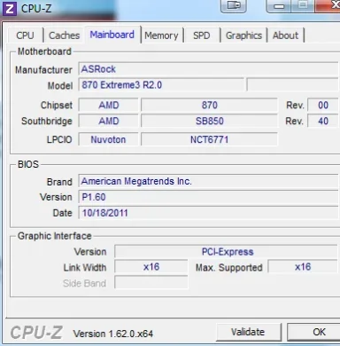

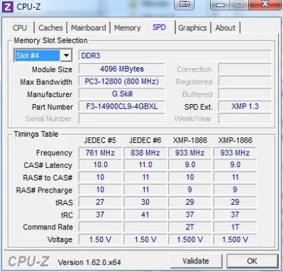

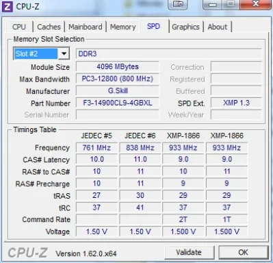

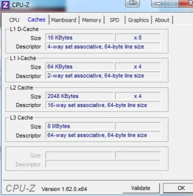

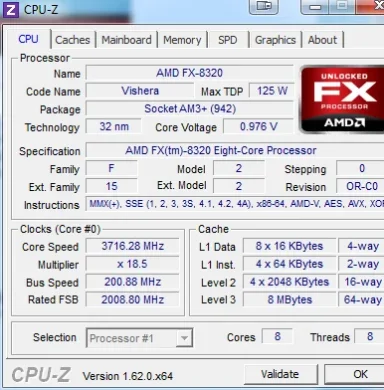

Since 2 months I'm getting these BSOD's. I suspect the soundcard, for no clear reason.
Help would be much appreciated.
