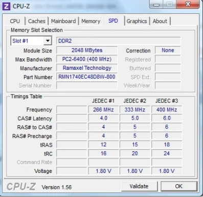

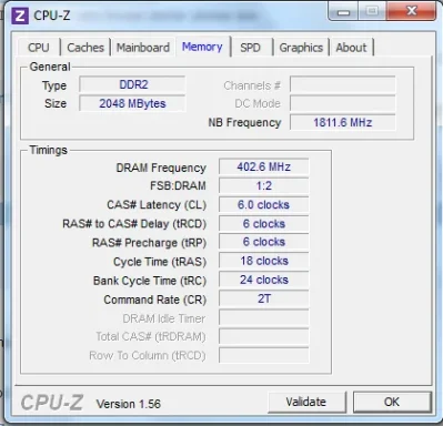

Hi there,
I just performed a clean install of Windows 7 Professional (32-bit) on my HP Pavilion dv5-1211AX laptop. I ran Windows Update and installed all the important updates. Everything seems to work fine until I try to wake from sleep mode. A BSOD will occur within 20 seconds of me attempting to wake it up. I know that this is an extremely common problem but I'm not particularly computer savvy so I wasn't able to glean much from reading the other threads created about this problem.
CPU-Z screenshots and minidumps are attached.
Thanks!
  • Minidump.rar
1. The memory is set right, thank you for attaching.
