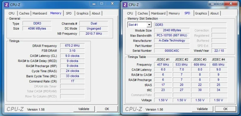

5) If crashes persist, post them. Then also post a screen shot of the spd and memory tabs of CPU-Z.

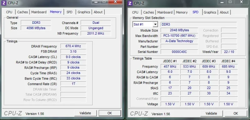

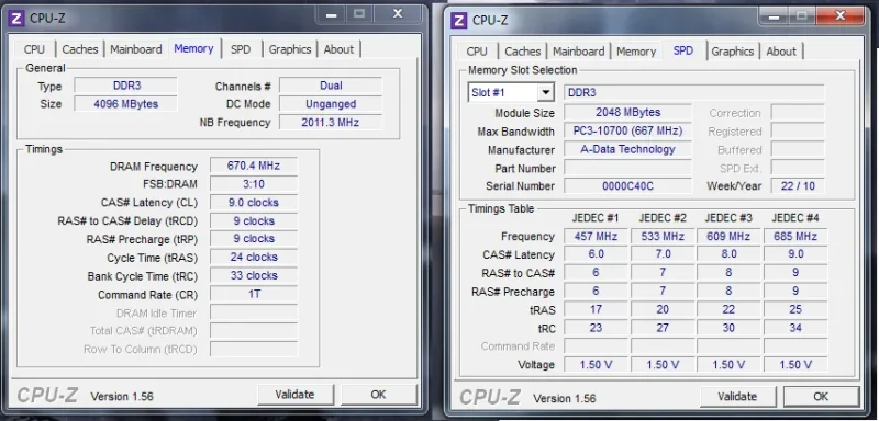

CPU-Z screenshots taken after I restarted:

The RAM is defective.
I ran the chkdsk, it said there were no bad sectors.
As far as defective RAM, I mentioned running Memtest a few weeks ago, and there were no errors over 20 hours.
Got a blue screen 2 minutes after loading WoW. I've switched back to my original graphics card as well (Radeon HD 5800).
View attachment 121310-17316-01.dmp
What I'm saying is technically final and conclusive. I wouldn't make a statement like that, otherwise.
Hey, sorry, I submitted my post early and have edited it with some more info, a screenshot and a dump file
