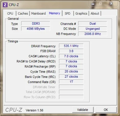

1. Link Removed
MEMORY and SPD tabs for each slot.
Give me these links or maybe pdf files with: your RAM sticks description + motherboard description.

Sorry about not posting from CPU-Z, didn't see that was needed.
It's needed every other time, that's why he made that thread sticky. In your case, the timing values are set wrong - this causes your freezes and sooner or later will cause you another BSOD.
DDR 1066 Mhz
Timing 7-7-7-20
Voltage 1.5v
DRAM options set on "Auto" in the bios almost always adjust themselves to the right values. If not, set them manually.
Its that simple?
I've reset and updated the BIOS already, so I guess [auto] doesn't fix it. I'll try to get the timings fixed manually.
I did the timings right, but not sure about the "DDR 1066 Mhz"
How can I check that? I thought I found it in the BIOS, and changed it from auto to 1066mhz.
