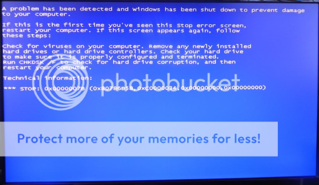

No, the same thing happens when booting in Safe Mode. I plugged the HDD into my computer and installed my graphics card's driver. I then put then HDD back into the old PC WITH my graphics card. But there was still no difference so it is not the graphics. What other drivers would I need to install? The only driver on the HDD so far is the graphics card: HD5670.
Here is the BSoD that pops up when automatic restart is disabled:
I am unable to deduce anything from it, although I'm not too good with this stuff.

The bug check code is INACCESSIBLE_BOOT_DEVICE check this Microsoft site for information and possible solutions.
If you need help with some of the information or procedures, or find more info, let us know.

It seems to be saying putting a drive in another computer is probably causing your problem. Using a different controller for a drive can have all types of different bad consequences.
The fact you could not install on the drive originally means something about the system and Windows 7. Maybe there is some driver you need to load during the install, but I can't tell.
When you tried to install Windows 7 in that computer, using that drive, what happened?
