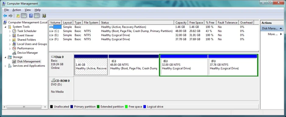

Can you post a screenie of your disk management for us? I agree, nearly 1.5gig is , err, a tad excessive!

If would be best if you used Disk Management and took a snipping tool picture and attach using the paperclip.

Ok, that's what I have done. The image should be attached to this reply ... I hope :)

Your problem is that your Disk drive is using D so you will need to change this to an unused letter and then D will again be available.

Hi jackoab. Thanks for replying, although unfortunately I haven't the foggiest idea what you mean. Do you see a "D:" anywhere in the screen capture in my last post? I certainly don't. Perhaps somehow "D" is assigned to that first partition that shows a blank as the volume label, but if that is the case I wouldn't know how to change it. If I right click on any of the other drives, there is a "Change Drive Letter and Paths..." in the context menu. However this doesn't happen for that first (recovery) partition. The context menu for that partition just says "Help". So what do I do?
Your cdrom device is D: change it to G and then change the partition you want to D:
This can all be done in disk management, right click on the cdrom and change it's drive letter first and then do the partition you want.
Oh my gosh ... how embarrassing. I've never had it assign the cdrom before the disk drives, so I wasn't even looking there. I can see why the earlier posters wanted to see a screen capture. I was looking for complicated explanations, but the answer was right there in front of me. Thanks for straightening me out!
