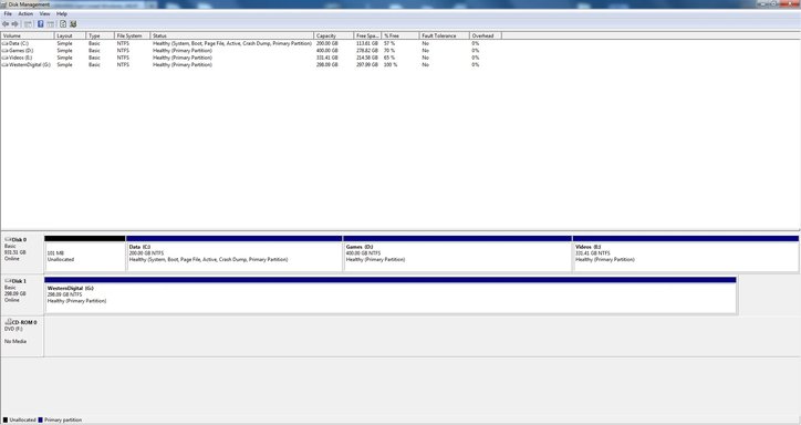

If you plug it into the new computer, can you get a picture of it in Disk Management? Make sure and expand it so we can see the partition descriptions and the left end that refers to the type of drive.
UEFI is a new bios system that is being used on some newer computers. For Windows 7 to use it, a GPT drive configuration is necessary. The older computer may not recognize it. This situation may not be relevant, but other than that, I could only suggest cleaning the drive before using it in the old computer. Diskpart can do that as you install. Let us know if you want to go that direction.

I doubt that it is the drive. If i put my hard drive (Seagate Barracuda 1TB) into the old computer, it still can't boot up. The same thing happens (restarts at "Starting Windows" screen). It must be something to do with the BIOS, because it can detect the drive in the BIOS, but when installing Windows 7 it says there are no drives detected and I must install a driver.
