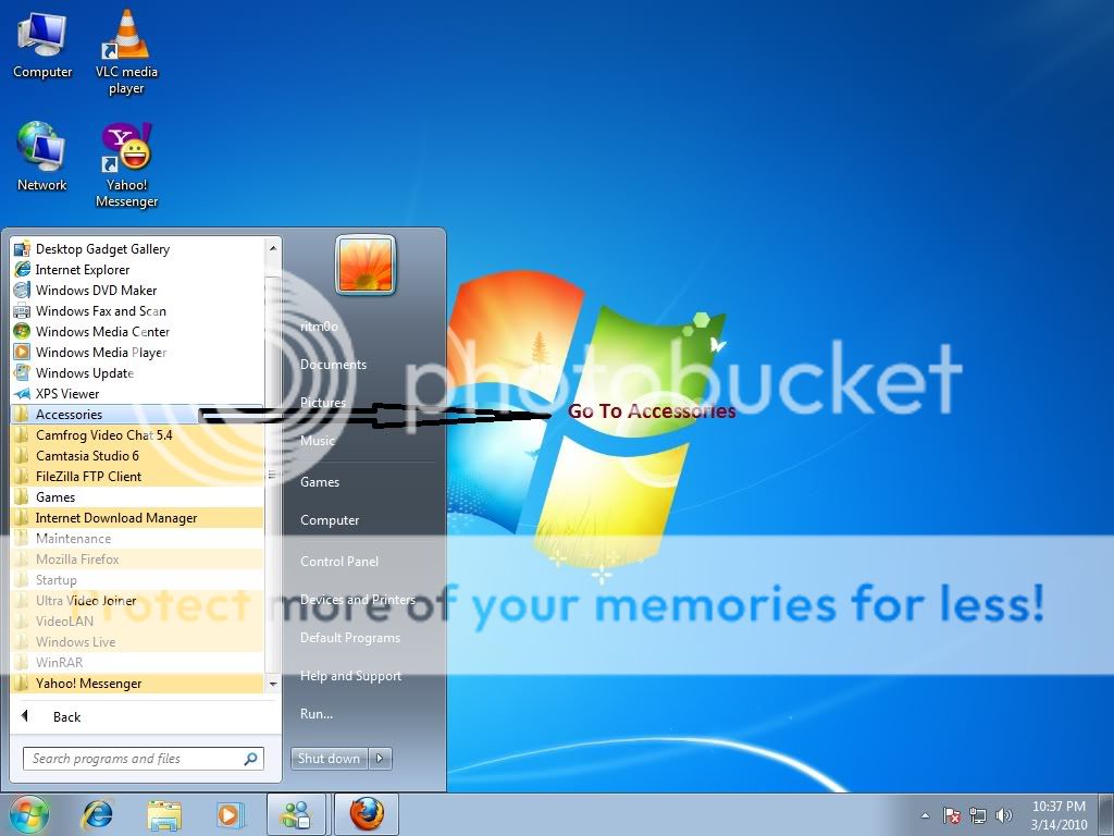

Hi Everyone,
ur all pro is solved
Plz Follow me step by step
Here Is the Tutorial.....
See Part 1.
See Part 2.
See Part 3.
See Part 4.
See Part 5. Final
#16
All OCX AND DLL Files is Successful (Enjoy)
