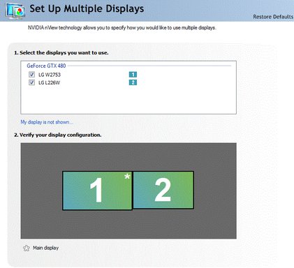

I have never run two monitors on my system, so I plugged in another monitor to test. The power was completely off when I plugged the second monitor using a DVI cable to the second output of the GTX 480. I made no setting changes in my system previously, but after boot, as soon as I logged in the second monitor showed up. It seemed to have a signal prior to logging in, but was black.
Attached is a picture of the Nvidia Control Panel.
