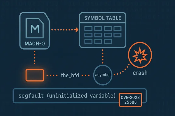

Diagram of a Mach-O segfault caused by an uninitialized variable (CVE-2023-25588) via the symbol table.Background​

CVE‑2023‑25588 arises from a code path that builds a synthetic symbol table for Mach‑O files: the function bfd_mach_o_get_synthetic_symtab. In certain code paths that construct symbols, the the_bfd field of an asymbol instance can remain uninitialized. When later code dereferences or otherwise depends on that field, the result is undefined behavior that manifests as a crash — a denial‑of‑service in practical terms. This class of flaw maps to CWE‑457: Use of Uninitialized Variable.
What exactly is broken (technical overview)​
How BFD, asymbol, and synthetic symtabs relate​
  • BFD provides a common API so tools like objdump, readelf, nm, and linkers can operate on multiple object formats.
  • asymbol is the BFD internal representation of a symbol; it carries fields such as name, section, value, and an associated BFD pointer (here, the_bfd).
  • The Mach‑O synthetic symbol table creation routine attempts to synthesize symbol entries when certain Mach‑O constructs are present; bfd_mach_o_get_synthetic_symtab is the routine that does this work for Mach‑O support.
If the_bfd remains uninitialized on a constructed asymbol, later code that assumes it points to a valid bfd structure may dereference it. On modern platforms that leads to crashes, process termination, and therefore service interruption. The practical impact is availability loss for any process or automation step that invokes Binutils on a crafted Mach‑O file.
