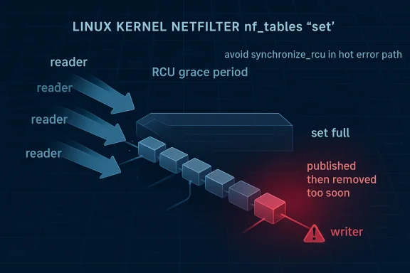

Diagram shows Linux kernel netfilter nf-tables RCU synchronization with readers, set full, and writer publishing too soon.

The kelet readers traverse data structures without blocking writers in the common case. The whole point is to allow readers to see a stable enough view while writers make changes carefully and defer reclamation until after a grace period. The RCU documentation emphasizes that freeing or reusing objects too early violates those guarantees and is exactly the sort of mistake the grace-period model exists to prevent. In other words, the bug is not just that an element was removed; it is that it could have been removed too soon for the readers who still had a legitimate path to it.
Why the set-full case is tricky​
The description says the issue arises when the set is already full. That is precisely when edge cases get ugly: the transaction has partially progressed, an element may have been published, and then the code discovers there is no capacity left. If the cleanup path does not preserve the same lifetime guarantees as the insertion path, the system can end up briefly exposing an element to readers and then tearing it down before RCU says that is safe. That is the kind of race that tends to evade simple testing because it depends on timing, load, and the tch operation.

Technical Root Cause​
The key line in the NVD summary is that a new element could be published then removed without waiting for the RCU grace period. That phrase is doing a lot of work. In kernel terms, publication means the object has become visible to readers; removal means the writer believes it is done with the object; RCU grace period means the kernel has verified that pre-existing readers are no longer using it. If those three events happen out of order, the system can create a use-after-free style hazard or, at minault that readers are not supposed to encounter.
The accounting bug underneath​
The patch summary says to unconditionally bump set->nelems before insertion. That suggests the old code path only updated the element count after it had already decided capacity was available, or it failed to keep the logical count aligned with the transaction state during error handling. In kernel code, count mismatches are rarely just bookkeeping mistakes. They often shape control flow, influence capacity checks, and decide whether cleanup code seesnserted or still transient.
The set_full flag and -ENFILE​
Instead of letting the operation fail in a way that leaves the set in an awkward partial state, the fix toggles set_full to report -ENFILE and then lets the abort path unwind cleanly. That is a deliberate contract change: the insertion path pretends to proceed far enough for the transaction model to remain coherent, even though the operation ultimately fails because the set is full. The result is less clever and more robust, which is often the right answer code.
Why not just wait for RCU?​
The description explicitly says a simpler fix would be to call synchronize_rcu() on the error path. That would certainly close the lifetime gap, but it would also impose measurable latency on batches that keep hitting full sets. On a system processing a large batch of element additions into a maxed-out set, that could turn a mostly bounded failure into a noticeable slowdown. Kernel maintainers are understandably reluctant to inject that kind of penalty into common networking paths unless they have no better ortance of preserving transactional symmetry
One of the more subtle lessons here is that writers and abort paths must agree on the shape of the transaction. If insertion and rollback do not describe the same object lifetime, then the code can briefly claim one reality to readers while trying to clean up another reality behind the scenes. That mismatch is exactly the kind of thing RCU is designed to prevent. The fix keeps the set transaction visible long enough for the abort path to reconstruct the prior state without racing readers.
