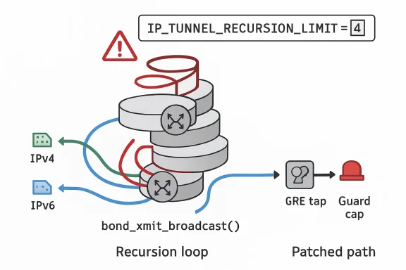

Diagram shows an IP tunnel recursion loop hitting a limit, then transitioning to a patched guarded path.

What Went Wrong​
The most direct version of the bug is easy to state: tunnel transmit helpers did nosion limit. Instead, they relied on broader transmit-path protections that were not tailored to the heavier stack usage of tunnel routing and encapsulation. When the recursion involved GRE tap slaves on a bond that also accepted the traffic back in broadcast mode, the result was a transmit loop that could keep climbing until the stack ran out.
Why the generic limit was not enough​
The kernel already had a recursion guard in the no-qdisc path, and 8 might sound conserv But the CVE description makes clear that tunnel recursion is not equivalent to simple device recursion. Each level can pull in route lookup, encapsulation handling, IP output, and additional bookkeeping, so the stack footprint per iteration is much larger than the transmit recursion model assumed.
That is why the fix does not merely “raise a limit” or “tweak a counter.” It changes the design by giving tunnel xmit functions a separate recursion cheld. In other words, the kernel now distinguishes between ordinary transmit nesting and tunnel-specific nesting, which is a more accurate model of the risk. That is the right architectural move, because a single universal cap can be too blunt for modern network stacks.
The stack trace in the CVE text reinforces that assessment. It shows repeated transitions through ip_output(), ip_finish_output2(), __dev_queue_xmit(), bond_xmit_broadl_xmit(), then back again, which is precisely the sort of repeated cross-subsystem flow that can silently evade a generic recursion guard until it is too late. The trace also shows the crash landing in blake2s.constprop.0, a reminder that a stack overflow need not fail at the recursion point itself; it can damage later code that merely inherits the corrupted stack state.

A useful way to think about the risk is to imagine the packet path as a loop rather than a line. The keansmit once, encapsulate once, and exit. When the topology causes the output path to rediscover itself, the packet becomes a recursive input to the same machinery that is trying to send it out. That is where stack consumption explodes.

The trace shows a repeating sequence: bond_start_xmit(), bond_xmit_broadcast(), __dev_queue_xmit(), ip_finish_output2(), ip_output(), and then back i/ ip_tunnel_xmit() and gre_tap_xmit(). That repeated choreography is a good illustration of how a network packet can be legitimate at every individual step while still becoming dangerous as a whole. Each component does the expected thing, but the composition creates a recursion trap.
