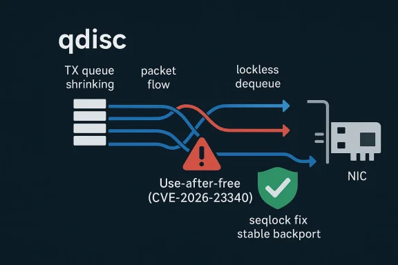

Network diagram showing aqdisc vulnerability—use-after-free (CVE-2026-23340) with seqlock fix and NIC.

At a high level, the bug appears when the kernel shrinks the number of real TX queues. The function netif_set_real_num_tx_queues() calls qdisc_reset_all_tx_gt() to flush qdiscs that belong to queues no longer in use. The problem is that the reset path assumed qdisc_lock() was sufficient serialization, while lockless qdiscs use qdisc->seqlock and qdisc_run_begin()/end() instead. In other words, two different synchronization models were being mixed without enough protection, and that mismatch created the race.
This is not a theoretical edge case. The kernel’s multiqueue documentation explains that hardware queue mapping is central to how packets move through the system, and the default queueing setup for multiqueue devices is designed to distribute traffic efficiently across queues. When queue counts change dynamically, the system has to reconfigure queue-related state without disturbing in-flight traffic. That is hard enough with traditional locked qdiscs; with lockless qdiscs, the margin for error is smaller.
The CVE description includes a reproducible stress scenario on virtio-net, involving heavy traffic and repeated changes to combined queue counts with ethtool -L. With KASAN enabled, the kernel can report a slab use-after-free in __qdisc_run(), showing that an skb was freed by the reset path while the dequeue path still believed it was valid. That kind of evidence usually pushes a bug from “interesting race” into “security-relevant memory safety issue.”
What Actually Broke​
The essential failure is simple to describe even if it is difficult to hit in practice. The reset path walked into data structures that the dequeue path could still be using. In a locked qdisc, qdisc_lock() gives the reset operation a reasonable claim to exclusivity. But in a lockless qdisc, that exclusivity is not the right abstraction, because packet dequeue is guarded by sequencing rather than the classic spinlock model.
When the reset path frees skbs that are still in flight, the dequeue code can later touch memory that has already been returned to the allocator. That is the classic shape of a use-after-free, and in kernel space it is dangerous even when it only causes a crash. In the worst case, memory corruption primitives can follow, which is why memory safety bugs in packet processing often receive close scrutiny from both maintainers and downstream distributors.

In this case, qdisc_reset_all_tx_gt() did not fully respect the lockless path’s contract. The fix described in the CVE record is to take qdisc->seqlock for TCQ_F_NOLOCK qdiscs, matching the model already used elsewhere in the networking stack. That is a meaningful clue: the kernel was not inventing a new synchronization strategy so much as aligning one code path with a pattern that already existed and had already been proven necessary.

The published fix does two important things. First, it serializes qdisc_reset_all_tx_gt() against the lockless dequeue path by taking qdisc->seqlock for no-lock qdiscs. Second, it clears QDISC_STATE_NON_EMPTY after reset so the qdisc state reflects the queue as empty and does not trigger needless rescheduling. Both steps matter: one prevents the race, and the other ensures the state machine behaves consistently after the flush.
The state-bit cleanup may sound minor, but it is not cosmetic. Queueing code is full of heuristics that try to avoid unnecessary wakeups, retries, or requeues. If a qdisc still believes it is non-empty after its packets have been reset, the scheduler may keep poking at it, creating overhead and possibly amplifying timing problems elsewhere. In a busy networking stack, small state mismatches can have outsized effects.
