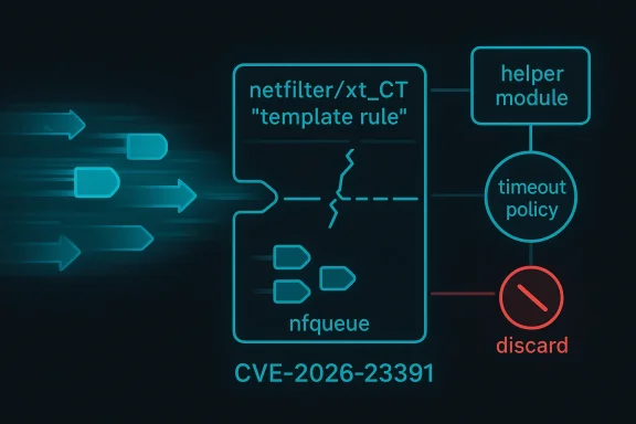

Cybersecurity diagram showing netfilter/xt_CT “template rule” helper module timeout policy leading to discard.
Linux kernel maintainers have assigned CVE-2026-23391 to a netfilter / xt_CT race condition fix that drops packets still sitting in nfqueue when a template rule is removed. The issue matters because the template can reference stateful objects such as a helper module or a timeout policy, and those objects may disappear before the queued packets are processed. In practical terms, the kernel patch closes a window where delayed packet handling could dereference stale configuration, so the safe behavior is to flush those enqueued packets as soon as the template disappears.

What the bug is actually doing​
At the heart of the issue is a mismatch between packet lifetime and template lifetime. A packet can be enqueued in nfqueue while an xt_CT template points to a helper or timeout policy that later disappears, leaving the packet in limbo with an invalid dependency chain. The patch’s stated remedy is straightforward: if the template rule is removed, flush the enqueued packets rather than let them continue toward a now-invalid target.
The description is careful to note that templates using zone and event cache filter are safe because those uses only copy values. That distinction is important because it separates value capture from object reference. The former is stable; the latter is only safe if the referenced object cannot be removed out from under the queue. In a firewall subsystem, that difference is the line between ordinary configuration and a race-prone state machine.
The dangerous path​
The unsafe path is the one that combines queued packets with a template whose backing object can vanish. That can happen during module removal, or when nfnetlink_cttimeout removes a timeout policy. If the queued packet is resumed after either event, the kernel may be forced to consult state that is no longer valid, which is exactly the sort of scenario that kernel hardening tries to eliminate preemptively.
The patch’s approach is conservative, and that is the right instinct here. Dropping enqueued packets is not glamorous, but it preserves kernel integrity and avoids making packet completion depend on torn-down template state. In security terms, fail closed is the correct answer when the alternative is continuing a flow through potentially dead references.
  • Queued packets can outlive the rule that queued them.
  • Helper modules can be unloaded while packets are still waiting.
  • Timeout policies can be deleted by userspace management.
  • Value-only templates are not the problem; object-backed templates are.
  • Flushing on removal is the least surprising and safest behavior.
