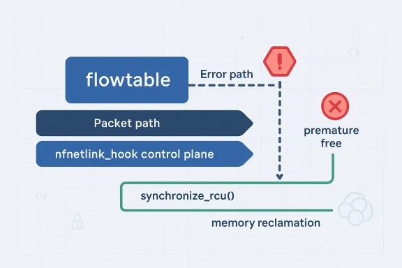

Diagram showing a flowtable packet path leading to an error path with “premature free” and memory reclamation.

What the bug actually does​
The core issue is a stale pointer window created during cleanup. The CVE description says that after unregistering hooks from the error path, the code should call synchronize_rcu() because a hook that refers to the flowtable may already have been registered. That means the flowtable can still be visible to packet processing and to the nfnetlink_hook control plane while the error path is trying to tear it down. If the object is released too early, any re or discovers a reference can encounter freed memory.

The CVE text explicitly says the flowtable becomes visible to the packet path and to the nfnetlink_hook control plane. That is a big deal because it means the object is not only used in forwarding decisions but also inspected or enumerated by management interfaces. A use-after-free in a dataplane object is already serious; a use-after-free that can cross into intros is even more troubling because it broadens the set of code paths that might dereference stale memory.

What the fix means technically​
The fix is straightforward: call synchronize_rcu() after unregistering hooks on the error path. That wait ensures any reader that could still see the flowtable has completed before the memory is released. In a high-performance kernel subsystem, that kind of wait is not free, but it is acceptable when the code is already on an exceptional path. The advisory notes that this path is y the kind of situation where correctness should take priority over micro-optimization.
