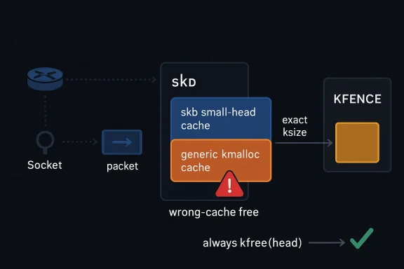

Diagram showing wrong cache free in kernel memory allocation (skd/skb caches) with an error warning.Why this bug is different from a typical allocator mistake​
Most allocator bugs are easy to describe in broad strokes but difficult to reproduce precisely. This one is interesting because the vulnerable condition depends on a combination of small details: a specific head size, KFENCE being enabled, and the skb free path making an allocator-origin decision based on size metadata. That makes the issue feel less dramatic than a classic memory corruption flaw, but not less important.
The key insight is that kernel safevoiding cleverness in the teardown path. If the free side tries too hard to infer provenance, it can end up making the wrong allocator decision under instrumentation or debugging configurations. The safest strategy is often the least specialized one, because a generic free path is less likely to be misled by allocator behavior that changes under sanitizers. That is the core lesson in this CVE.

The upstream fix is straightforward: always call kfree(head) in skb_kfree_head. That eliminates allocator-specific misclassification logic and lets the generic free path handle the object according to the allocator’s own bookkeeping. The patch deliberately avoids trying to preserve a special-case decision based on size or cache identity, because that was the very logic that KFENCE broke.
That design chonel maintainers usually prefer fixes that reduce special-case behavior in teardown paths, especially if the bug can be eliminated by using a more generic primitive. This approach lowers the chance that future allocator behavior changes, sanitizer modes, or architecture-specific bucket sizes will recreate the same bug in a new form. In short, the patch does not just fix one bug; it also removes an entire class of assumptions.
The result is cleaner code and a morth. kfree is the natural partner for heap allocations whose origin may be ambiguous or may vary under instrumentation, and using it here means the skb teardown logic no longer needs to second-guess allocator provenance. That is a much better long-term posture for a hot kernel path.
