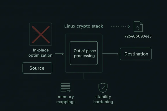

Diagram showing Linux crypto stack with out-of-place processing, destination file, and stability hardening.
In the Linux kernel, CVE-2026-31431 marks a small but telling correction in the algif_aead crypto interface: the code is being pushed back toward out-of-place operation after a prior attempt to optimize for in-place handling proved unnecessary. The published description says the fix mostly reverts commit 72548b093ee3, except for copying associated data directly, because the source and destination already come from different mappings and there is no practical benefit to the added complexity. That makes this a classic kernel-maintenance vulnerability: not a dramatic exploit headline, but a reminder that subtle design choices in low-level code can create real security and stability risk when they overcomplicate a path that did not need to be clever in the first place. The record was newly published from kernel.org and surfaced in Microsoft’s vulnerability guide on April 22, 2026, with NVD still awaiting a final CVSS assessment at publication time. rst thing to understand about algif_aead is that it sits in a layer of the Linux crypto stack that is easy to overlook until something goes wrong. It is not a flashy application-level API; it is part of the kernel’s interface for authenticated encryption, where correctness depends on the careful choreography of buffers, mappings, and metadata. The recent CVE record indicates that maintainers decided the attempted in-place path was not worth the added complexity, because the source and destination do not naturally share the same mapping context.
That matters becauslives at a junction where performance tuning can collide with memory-safety discipline. A path that looks elegant on paper can become fragile if it tries to reuse buffers in ways the surrounding subsystem does not actually support. In this case, the engineering judgment appears to have shifted back to a simpler and more defensible model: operate out-of-place, and only preserve the direct copying of associated data.
The record’s wording is also revealing. a classic exploit primitive such as an overrun, use-after-free, or privilege escalation. Instead, it reads like a correctness-driven security fix that removes unnecessary branching and state handling from a sensitive kernel path. That kind of change often lands in the CVE system because the Linux kernel treats reliability and security as intertwined, especially where a bug can turn into memory corruption, undefined behavior, or hard-to-debug cryptographic failures under certain call patterns.
For operators, the important question is not whether this is t makes headlines. It is whether the affected kernel build is in use and whether the vendor backport has landed. With Linux CVEs, especially ones sourced from kernel.org stable commits, the practical exposure window is often defined less by the upstream fix and more by how quickly downstream distributions, appliances, and vendor kernels absorb it. That is why this entry deserves attention even before NVD has assigned a formal severity score.
What Changed in algif_aead​
At a technical level, the fix is described as ommit 72548b093ee3. The kernel maintainers evidently concluded that the in-place optimization created complexity without buying meaningful benefit in this path. The source and destination buffers already originate from different mappings, which means the optimization was at best awkward and at worst a maintenance hazard.
That is an important design correction because crypto code is one of those areas where the easiest-look the worst lifetime cost. If a subsystem’s input and output are already segregated by memory mappings, forcing them into an in-place model can introduce extra branches, extra state transitions, and more opportunities for mistakes. The published description suggests maintainers decided that direct copying of associated data was the only part worth keeping from the earlier change.
Why out-of-place is simpler​
Out-of-place processing is not automatically slower in a meaningful way when the system’s rt support true in-place reuse anyway. In this case, the source and destination do not share the same mapping context, so the “optimization” was more conceptual than practical. Removing it reduces the code path’s cognitive load, which is often a security improvement in itself because simpler kernel logic is easier to reason about, test, and backport.
The broader lesson is that less clever code is often safer code in the kernel. When a feature is built on an assumption that does not hold in tmodel, it may still compile, but it will accumulate awkward edge cases that become maintenance debt. CVE-2026-31431 looks like a cleanup of exactly that sort of debt.
