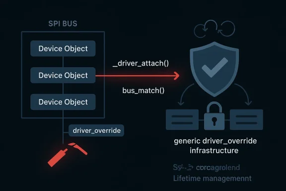

Diagram showing SPI bus device objects with driver_attach and bus_match leading to generic driver override infrastructure.

At the center of the issue is the driver_override field, a kernel mechanism that lets a specific device be forced to bind to a specific driver name rather than follow the normal matching rules. The Linux documentation says userspace can override standard matching by writing a driver name to the driver_override sysfs attribute, and the driver core provides helpers such as device_match_driver_override and device_set_driver_override so subsystems do not have to reinvent the wheel. SPI’s bug arose because its matching path was touching that state in a way that assumed the object remained safe to read without the device lock.
The important technical point is that __driver_attach intentionally calls match without holding the device lock. That is not a defect in itself; it is part of the design of the driver model. The problem appears when a bus-specific match callback reaches into fields whose lifetime or synchronization rules depend on the lock thaer words, the bug was not the absence of a lock in __driver_attach; it was SPI’s reliance on a field that needed more careful handling than the subsystem was giving it.
How the race can become dangerous​
When the bus callback examines driver_override without the correct protection, it can race with another operation that clears, changes, or frees that field. If the object is torn down or reconfigured at just the wrong moment, the callback can end up dereferencing memory that no longer belongs to the device. That is the textbook shape of a xact exploitability will depend on surrounding kernel state, but from a defensive standpoint the mere existence of the race is enough to warrant a fix.
This also explains why the patch is framed as a transition to the generic infrastructure rather than a local band-aid. The driver core already knows how to enforce the correct locking semantics for driver_override, so letting SPI continue to do its own thing would just preserve a fragile duplication. Kernel code ages badly when two different subsystems each maintain slightly different versions of the same ownership logic. The maintainers are effectively choosing consistency over subsystem special-casing.

What the Fix Changes​
The upstream description is clear that the generic driver_override infrastructure instead of accessing SPI’s own override handling in a way that sidesteps the locking guarantees. That shifts responsibility to code in the driver core that was designed to handle this exact sort of state safely. It is the sort of fix that is small in terms of lines changed but large in terms of architectural significance.
The driver model documentation lays out the intended pattern: buses that support driver override should use device_match_driver_override in their matching logic, and driver-core helpers are available to set or clear the override. That makes the SPI fix look less like a one-off and more like a correction toward the kernel’s preferred design. When a subsystem is already close to the canonical pattern, moving the last few pieces into alignment is often the safest possible route.
