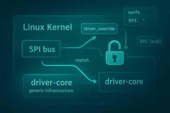

Diagram showing Linux kernel driver workflow: SPI bus connects to driver-core via match, guarded by a lock.

The vulnerability description says the problem arises when a driver is probed through __driver_attach(), which calls the bus’ match() callback without the device lock held. That matters because the SPI implementation historically accessed driver_override in that callback path without adequate synchronization, creating a race window that can become a use-after-free . In kernel terms, that is the kind of bug that hides in plain sight because the control flow is intentional, but the object lifetime assumptions are not.
The fix is to use the generic driver_override infrastructure in the driver core, which is designed to handle the locking correctly internally. The kernel’s own change note makes clear that the match() call from __driver_attach() without the device lock is intentional, so the real problem is not the call site itself, but the SPI bus implementation’s handling of override state in that context . That distinction is important because it explains why the patch is architectural rather than merely cosmetic.
There is also an SPI-specific wrinkle that makes this case more interesting than a standard driver-core cleanup. The advisory notes that SPI does not enable the driver_override feature of struct bus_type, because unlike most other buses it passes "" to sysfs_emit() when the pointer is NULL, rather than printing (null) . That means the fix had to preserve user-visible behavior while still adopting the safer generic locking model.

At a high level, this is a use-after-free risk caused by reading driver_override in the wrong protection context. The SPI bus’ match logic could examine that field while another thread or subsystem was concurrently changing or releasing it, and the kernel would not necessarily catch the bad lifetime until memory had already been repurposed. That is exactly the sort of bug that can stay latent for a long time and then surface as a rare, hard-to-reproduce crash.
The detail that __driver_attach() intentionally calls match() without the device lock held is what makes this subtle. In normal developer intuition, “no lock” often sounds like a bug in itself, but here the absence of that lock is part of the driver-core design . The safety guarantee therefore has to come from the override infrastructure, not from every bus implementation reinventing its own locking rules.

Why Generic Driver-Override Infrastructure Matters​
The phrase generic driver_override infrastructure sounds mundane, but in practice it is the right kind of boring. The kernel has learned, over years of bug fixing, that every subsystem-specific copy of a basic lifecycle pattern becomes a place where subtle differences creep in. By consolidating override handling in the driver core, SPI inherits locking discipline instead of reimplementing it manually.
That matters because locking is not just about preventing races in the abstract. It determines whether the kernel can reason about the validity of a pointer at a specific moment. If the generic layer already knows when the override state can be observed and when it can be mutated, then bus code becomes less error-prone and easier to audit. The fix therefore improves both safety and maintainability.
The SPI exception is not trivial​
The advisory’s note about SPI not enabling the driver_override feature of struct bus_type is the kind of detail that tells you this patch was carefully engineered, not mechanically applied. SPI’s sysfs output convention is different: when the pointer is NULL, it emits an empty string rather than the more common (null) text used elsewhere . That sounds cosmetic, but in kernel interfaces, user-visible text can become ABI-adjacent behavior very quickly.
Preserving that behavior means the patch had to avoid breaking tooling, scripts, or diagnostics that already expect the SPI-specific presentation. In other words, the fix had to improve locking without changing the subsystem’s external semantics. That is often the hardest kind of kernel change to land cleanly.

The Sysfs Detail Is a Clue, Not a Footnote​
One of the most revealing parts of the advisory is the note that SPI passes "" to sysfs_emit() when driver_override is NULL, instead of the more common (null) output . That detail looks tiny, but in kernel work, tiny details often explain why a bug persisted and why the fix had to be careful.
The point is not simply that SPI is “different.” The point is that its external behavior has become part of its interface contract. Any attempt to turn on the generic driver_override bus feature wholesale could change that contract and create user-visible regressions. So the developers took a more surgical route: adopt the generic locking benefit without exposing the generic formatting behavior.
