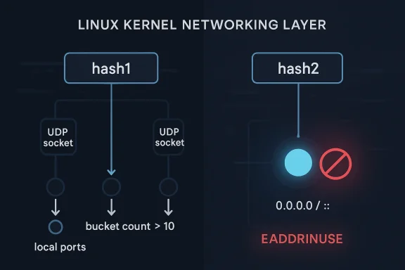

Diagram shows Linux kernel networking layer with hash1/UDP local ports vs hash2 with EADDRINUSE error.
Linux systems picked up another networking CVE this week, and CVE-2026-31503 is a good reminder that some of the most consequential kernel bugs are not dramatic memory corruption flaws but logic failures in trusted packet paths. The issue lives in UDP bind conflict checking, where the kernel can switch from a port-only hash to an address-plus-port hash once a bucket grows large enough, and in that transition it can miss wildcard conflicts that should have blocked a bind. The result is a subtle but serious correctness problem: a socket that should have been rejected with -EADDRINUSE may be allowed to bind anyway once the hash2 path is in play. The vulnerability was recently published by the Linux kernel and surfaced in Microsoft’s vulnerability tracking as a new advisory entry, with the upstream fix already identified in stable references. nding looks deceptively simple from the outside. A process asks the kernel for a local address and port, and the kernel either reserves that tuple or rejects it if something else is already using the same space. Under the hood, however, Linux has to balance performance and correctness across many sockets, multiple address families, and wildcard semantics that vary depending on whether the request came from IPv4, IPv6, or an IPv4-mapped form. That is where the bug begins: the kernel uses two different hash tables for collision detection, and the threshold that decides which one to consult can change the outcome of the bind check.
The newly published switch to hash2 happens once hslot->count > 10. In the ordinary hash path, the check is keyed by local port only, which is broad enough to notice wildcard conflicts in many common cases. In the hash2 path, the key includes both local address and local port, which is more precise for heavily populated buckets but can accidentally narrow the scope of the conflict test. That is the heart of the flaw: precision is good, but not if it causes the kernel to forget that a wildcard bind must still collide with sockets already using the same port on other local addresses.
This is not an abstract theoretical issuout a concrete sequence: bind ten sockets to different addresses on the same port, then attempt a wildcard bind to that port. With the ordinary hash path, the kernel correctly returns EADDRINUSE. Add one more socket so the bucket count crosses the threshold, and the kernel switches to hash2; at that point, the wildcard bind can succeed even though it still conflicts logically with the existing listeners. That kind of boundary bug is exactly the sort that survives testing because the system behaves correctly most of the time, then breaks only at scale or under specific address-mix conditions.

Hash1 Versus Hash2​
The vulnerability description is unusually clear about the two lookup structures. hash is keyed by local port only, while hash2 is keyed by local address and local port. That distinction makes sense from a performance perspective: a busy system with many sockets on the same port needs a more selective index to avoid checking everything in one policy check for wildcard binds cannot be narrowed that far without considering the broader exclusivity rule.
What makes this interesting is that the issue is not “hash2 is wrong” but “hash2 is incomplete for this use case.” That is a crucial distinction. The more selective structure is probably the right tool for many collision checks, yet wildcard binds need a wider view because they conflict with more than just exact-address matches. The fix therefore has to preserve the benefits of hash2 while restconflict semantics that wildcard requests rely on.
