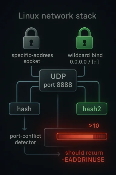

Diagram of a Linux networking stack showing UDP port 8888, hash routing, and address reuse error.
CVE-2026-31503 is a small-looking Linux kernel networking fix with outsized operational significance: UDP’s port-bind conflict detection could miss a collision when the code switched to the newer hash2 lookup path, allowing a wildcard bind such as [::]:8888 or 0.0.0.0:8888 to succeed even though specific-address sockets were already occupying that port. The advisory describes the flaw as affecting both IPv6 and IPv4 wildcard binds, including IPv4-mapped wildcard cases, and notes that the TCP side already has the correct helper logic, which the UDP fix reuses after renaming and moving it into a shared header ic example of a boundary-condition regression in a kernel fast path. The code chooses between udptable->hash and udptable->hash2 depending on bucket pressure, but the wildcard conflict check was not mirrored correctly once hash2 became active. That means the kernel could accept a bind it should have rejected with -EADDRINUSE, which is not just a correctness problem: it can break service isolation, confuse daemons that assume exclusive port ownership, and create hard-to-diagnose networking behavior under load.
What makes the issting is the trigger pattern. The record gives a concrete reproduction sequence: after enough sockets are already bound to the same port on distinct local addresses, the socket hash bucket count crosses the threshold where hash2 becomes active, and the wildcard bind suddenly slips through. The threshold matters because it means the failure is state-dependent, not universal; systems with light socket churn may never notice it, while busy hosts, service meshes, container nodes, and multi-homed servers are more likely to run into the bad path.

UDP bind semantics in Liimple on the surface: a socket binds to a local address and port, and the kernel ensures that no conflicting bind slips through. Under the hood, though, the kernel has to balance correctness and performance, because port lookups happen constantly and the socket tables can become crowded quickly. That is why Linux uses hashing strategies to reduce the cost of collision checks, and why those strategies have to preserve exact bind semantics even as they optimize for scale.
The advisory for CVE-2026-31503 explains that UDP uses two hashes for collision detection: one keyed by local port only, and another keyed by local address plus local port. The switch to hash2 happens when a hash-slot count exceeds 10, which is a sensible performance optimization in busy environments. The problem is that wildcard binds depend on conflict detection across all addresses on a port, and a hash function chosen for performance can quietly weaken the conflict check if the bind logic is not careful enough.
This is the sort of bug that tends to survive for a while be works. A single socket, or even a handful of sockets, may never cross the threshold that activates the alternate path. Once the table is dense enough, however, the kernel’s behavior changes in a way that ordinary testing may not cover. That is why the advisory’s pseudo-code is useful: it shows a realistic bind sequence, not an artificial memory-corruption trick or a contrived packet payload.

At the center of the vulnerability is a mismatch between where the kernel looks for conflicts and what kind of bind is being attempted. A specific-address bind, such as fd00::3:8888, naturally interacts with a narrower set of entries than a wildcard bind, which must respect all sockets already holding the port. If the kernel uses the wrong lookup path when the table is crowded, it can fail to notice a conflict that should have blocked the bind.
The advisory says the current code switches to hash2 once hslot->count > 10. That is a useful optimization for narrow-address lookups, but it also raises a subtle problem: the wildcard bind conflict check must remain broad enough to catch all relevant existing sockets. The report shows that before the bucket gets crowded, the code correctly returns -EADDRINUSE; after one more socket pushes the bucket past the threshold, the wildcard bind can unexpectedly succeed. That is the heart of the bug.
Why wildcard bindrd binds are not just another address form. They are a promise that the socket intends to listen broadly, across all local interfaces for the selected port. That means the kernel has to be stricter, not looser, when deciding whether the port is already in use. A failure in that logic can let two components believe they own the same port, which is a recipe for packet delivery confusion, service startup failures, or inconsistent failover behavior.​
Why the threshold matters​
The threshold of 10 is important because it means the bug is not rooted in a permanently broken algorithm. Instead, the kernel behaves correctly until the density of sockets tips it onto a different code path. That is often the worst kind of bug from an operator’s perspective because it creates a split-brain effect: one environment or one moment in time works, while another almost identical setup fails in a way that is difficult to reproduce.

The Failure Mode​
The advisory’s example sequence is the clearest evidence of how the bug behaves in practice. Ten sockets bind to fd00::1 through fd00::10 on port 8888, then a wildcard bind is attempted. At that point the kernel still detects the conflict correctly. Once another socket is added, pushing the relevant hash slot count higher, the next wildcard bind on the same port can succeed unexpectedly. The same pattern applies to IPv4 wildcard binds and IPv4-mapped wildcard addresses su`.

Why hash2 Changes the Risk​
The key technical insight in the CVE record is that hash2 is keyed by local address and local port, while the original hash is keyed by local port only. That difference is useful for scaling, but it also means the kernel must carefully preserve the semantics of wildcard conflict detection when it switches between them. If the wrong hash path is used for a wildcard bind, the lookup cand miss an existing occupant of the port.
That is why the fix mentions reusing TCP’s existing helper. The TCP path already had the right logic in inet_use_bhash2_on_bind, and the patch renames it to inet_use_hash2_on_bind while moving it to inet_hashtables.h so UDP can call the same decision logic. That is a strong sign that the bug was not unique to UDP’s concept of binding, but rather to duplication and inconscol implementations.

The report says the TCP helper inet_use_bhash2_on_bind already had the correct check, and the fix for this CVE renames it to inet_use_hash2_on_bind and moves it into inet_hashtables.h so UDP can extbook stable-tree patch: small, mechanical, easy to reason about, and directly tied to the misbehavior described in the advisory.
