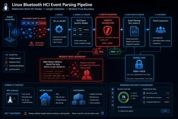

Diagram titled “Linux Bluetooth HCI Event Parsing Pipeline” showing length validation and a broken trust boundary risk.
CVE-2026-31771 is a high-severity Linux kernel Bluetooth flaw disclosed on May 1, 2026, in which malformed short HCI event frames could reach wake-reason address handling before per-event payload-length validation occurred. The bug is not a Windows vulnerability in the narrow sense, but it matters to WindowsForum readers because Microsoft’s security ecosystem increasingly surfaces Linux kernel CVEs through WSL, Azure, Defender, containers, appliances, and mixed-device fleets. Its lesson is larger than Bluetooth: modern platform security often fails in the small gap between “we parsed the packet” and “we proved the packet is long enough to trust.” For administrators, the practical question is not whether every laptop is instantly exposed, but where Linux Bluetooth stacks sit close enough to untrusted radios to turn a kernel bookkeeping mistake into a real operational risk.
A Bluetooth Wake Path Became a Kernel Trust Boundary​
The phrase “wake reason storage” sounds like a diagnostic footnote, the sort of subsystem plumbing that only kernel maintainers and power-management obsessives should ever need to think about. In practice, it sits at a surprisingly sensitive intersection: Bluetooth event processing, suspend and resume behavior, device identity, and kernel memory safety.
The vulnerable path lived in the Linux Bluetooth Host Controller Interface event handling code. HCI is the layer where the host operating system and the Bluetooth controller exchange commands and events. When a controller reports that something happened — a connection request, an advertising report, a connection completion, or another radio-side event — the kernel receives an HCI event packet and dispatches it to the appropriate handler.
CVE-2026-31771 turns on a simple ordering mistake. The kernel stripped the generic HCI event header and then called hci_store_wake_reason() before the event-specific handler enforced the minimum payload length for that particular event. That meant a short HCI event frame could arrive at code that copied a Bluetooth device address before the kernel had proved that the frame actually contained the bytes being copied.
That is the kind of bug that rarely looks dramatic in a changelog and often looks obvious in hindsight. The kernel already had a table of event handlers and minimum payload lengths. The missing defense was not a brand-new mitigation or a sweeping redesign; it was the discipline of ensuring that every consumer of event data sits behind the validation gate, not beside it.

The Bug Is About Validation Order, Not Bluetooth Pairing Magic​
Many Bluetooth security stories revolve around pairing, encryption negotiation, device spoofing, or user consent prompts. CVE-2026-31771 is less theatrical. It is about when the kernel decides that a packet is structurally safe to inspect.
The description makes the relevant sequence clear. hci_event_packet() receives an HCI event, strips the general event header, and at that early point the older code could call hci_store_wake_reason(). Only afterward would hci_event_func() enforce the per-event minimum payload length listed in the HCI event table. The vulnerable moment was the gap between generic parsing and event-specific validation.
That gap matters because a Bluetooth address copy routine such as bacpy() assumes that its source points to a valid bdaddr structure. If the packet is shorter than the event type requires, code can read beyond the bytes that actually arrived. Depending on memory layout, compiler behavior, sanitizers, and the exact path, that kind of bug can become an information leak, a crash, or a primitive that defenders would rather not hand to an attacker at all.
The fix is architecturally conservative. Instead of teaching hci_store_wake_reason() to re-parse every possible HCI event and duplicate length checks, the patch moves wake-address storage into the individual event handlers that already validate their own payloads. In other words, the kernel now records the wake address only after the relevant handler has established that the event body is long enough to contain that address.
That is the right kind of repair. Security fixes are strongest when they remove a bad ordering assumption rather than scattering new conditional checks across a path that future maintainers may accidentally bypass. The change also narrows the helper’s responsibility: it stores an already-validated address while the caller holds the Bluetooth device lock.
