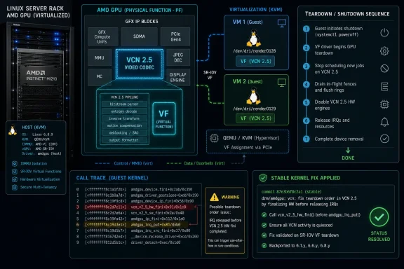

The bug description is blunt. On VCNv2.5, a VF does not enable the VCN poison interrupt, yet the cleanup path attempted to release it anyway. The result was a warning in amdgpu_irq_put() and a call trace during deinitialization, shown in the report against an Ubuntu 22.04-derived 6.8 generic kernel running under Red Hat KVM/RHEL hardware virtualization.
That distinction matters. This is not a browser sandbox escape, a wormable SMB defect, or a GPU memory disclosure with immediate cloud-hosting implications. It is a kernel driver state-management flaw that appears when the driver unwinds a virtualized AMD GPU function and discovers that the bookkeeping does not match the hardware reality.
But kernel security is not only about remote code execution. A kernel warning in a teardown path can still matter because teardown paths are where systems are most brittle: module unloads, device resets, VM shutdowns, host maintenance, passthrough handoffs, and error recovery. The closer a bug sits to those paths, the more it intersects with the daily work of administrators who need machines to survive routine operations.
The Interesting Word Is “VF,” Not “Poison”​
The acronym that carries the real weight here is VF. In PCIe virtualization, a physical GPU can expose virtual functions so that guest systems or isolated workloads interact with a slice of the device rather than the entire physical function. That model is central to SR-IOV-style designs and to the broader enterprise ambition of making GPUs schedulable, shareable, and manageable infrastructure.
The CVE’s “poison IRQ” language sounds dramatic, but in this context it is driver machinery. RAS, or reliability, availability, and serviceability, features often deal with poison events: hardware-detected faults, corrupted data paths, or error-signaling mechanisms that need software attention. An interrupt associated with that machinery is useful only if the particular hardware path enabled it in the first place.
The failure here is the mismatch. The VF path did not enable that VCN poison interrupt on VCNv2.5, but the shutdown code acted as if it had. When the driver later tried to put, or release, an interrupt reference that was never acquired, the kernel complained.
That makes the patch conceptually simple: skip releasing the VCN poison IRQ on VF. The fix is less a redesign than a correction of the driver’s mental model. The VF is not a smaller physical function; it is a different operating mode with different initialization and cleanup obligations.

The trace included with the CVE record is familiar to anyone who has debugged kernel driver failures. It begins with DRM cleanup, hits a warning in amdgpu_irq_put(), and shows rmmod as the process context. The system is tainted by out-of-tree or externally built modules, which is common in GPU and vendor-driver testing environments.
It would be easy to dismiss this as a noisy warning. After all, the record does not describe privilege escalation, arbitrary write, or information disclosure. The NVD entry has no severity score yet. The fix appears to be a small guard around an IRQ release call.
That dismissal would be too casual. Kernel warnings during teardown are operationally significant because teardown is often chained to other actions. A VM stops, a device resets, a module unloads, a host migrates workload, a service restarts, and suddenly a warning that seemed harmless becomes the first clue in a longer stability problem.
The trace also shows the bug appearing under KVM, which is exactly where virtual GPU edge cases tend to surface. Virtualization forces drivers through code paths that bare-metal desktop users may never touch. A Radeon card sitting in a gaming PC may never encounter this condition, while the same hardware family in a lab, VDI node, passthrough workstation, or cloud-adjacent setup might.

The fix itself is narrow. It does not claim to redesign AMDGPU virtualization, rework RAS handling, or change VCN initialization. It simply avoids releasing an interrupt that the VF never enabled.
That kind of patch is both reassuring and frustrating. Reassuring, because small conditional fixes are easier to audit and less likely to introduce sweeping regressions. Frustrating, because the operational symptom may be buried inside larger kernel update cycles, especially for distributions that backport fixes without changing the visible major kernel version.

This is not a panic-button vulnerability, but it is not meaningless paperwork either. It is a narrow kernel fix with a clear operational signature, relevant mainly to Linux systems using AMDGPU virtual-function paths around VCNv2.5 and driver deinitialization.
  • Systems that do not run AMDGPU, do not expose AMD GPU virtual functions, and do not use the affected VCN teardown path are unlikely to have meaningful exposure to this specific issue.
  • Hosts running AMD GPU virtualization should verify whether their distribution or vendor kernel has incorporated the stable fix referenced by the CVE record.
  • Administrators should look for call traces involving amdgpu_irq_put() and vcn_v2_5_hw_fini() during module unload, VM shutdown, device reset, or host maintenance.
  • Windows guests using AMD GPU passthrough or virtualized GPU resources depend on the Linux host’s AMDGPU behavior, even though the CVE is not a Windows kernel bug.
  • The lack of an NVD CVSS score should not delay environment-specific triage, because the deployment context determines whether the bug is irrelevant noise or a maintenance reliability concern.
