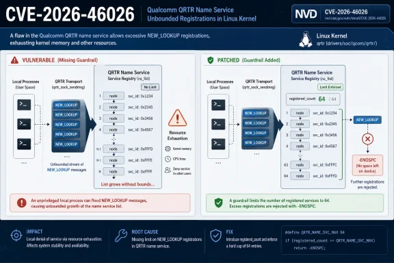

Infographic showing Linux kernel vulnerability CVE-2026-46026 in Qualcomm QRTR name service and its guardrail fix.

The fix for CVE-2026-46026 is almost comically modest: add a counter, define a maximum, refuse additional lookup registrations once the system reaches that ceiling, and decrement the counter when lookups are removed. In patch form, this is not the sort of change that makes security teams spill coffee. It is a resource limit.
That is exactly why it matters.
QRTR, the Qualcomm IPC Router support in Linux, exists to let the application processor talk to other subsystems on Qualcomm platforms: modems, DSPs, wireless components, and similar pieces of silicon plumbing. The affected code lives in the QRTR name service, where clients can register interest in services by sending lookup requests. Before the patch, the kernel accepted those lookup requests from local clients without a hard global cap.
The vulnerability description is blunt: a malicious local client could flood NEW_LOOKUP messages over the same socket. Because each lookup consumed kernel-managed state, the absence of a ceiling created a resource-exhaustion risk. The repair limits the maximum number of lookups to 64 globally, a value the patch notes say was chosen around current platform requirements.

The original code already restricted lookups to local clients. That is a meaningful boundary, and it should reduce panic. But it is not the same thing as resource control.
Local-only bugs live in a strange place in security triage. They are easy to dismiss because they require an attacker to already have some foothold. They are also easy to abuse precisely because local code can often make calls repeatedly, cheaply, and at machine speed. If the kernel allocates memory or list entries for each request and never says “enough,” a non-privileged local actor may be able to pressure the system in ways the original subsystem designer did not expect.
The CVE-2026-46026 patch adds QRTR_NS_MAX_LOOKUPS with a value of 64. It also introduces a global lookup_count in the QRTR name service state and checks that count before allocating and recording another lookup. When the limit is hit, the function returns -ENOSPC, the traditional “no space left” signal, rather than continuing to grow the list.
That choice says something about the maintainers’ view of the bug. This is not a complicated correctness repair. It is admission that “only local clients can do this” was not a sufficient safety property. The system needed a budget.
The patch note also says the name server allows at most one local observer, making a global lookup count sufficient. That matters because the correctness of the limit is tied to the architecture of the component. If there were many independent observers, a single global cap might create fairness or starvation problems. Here, the maintainers appear to be saying the model is constrained enough that a global ceiling is the simplest safe answer.

The patch says 64 was chosen based on current platform requirements and can be increased later if requirements change. That is a pragmatic kernel-maintainer sentence: small enough to stop a flood, large enough not to break known hardware, and explicit enough that future breakage has somewhere to point. It is also a reminder that kernel security is full of trade-offs that look arbitrary from the outside because they are grounded in hardware nobody wants to regress.

  • CVE-2026-46026 affects the Linux kernel QRTR name service path for lookup registration, not the whole Linux networking stack.
  • The documented abuse scenario is a malicious local client flooding NEW_LOOKUP messages over the same socket.
  • The upstream fix limits QRTR name service lookups to 64 globally and returns an error once that ceiling is reached.
