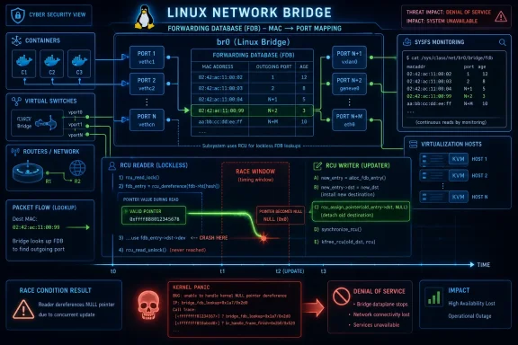

Linux network bridge FDB MAC-to-port mapping diagram showing an RCU race causing kernel panic and DoS.
Kernel.org assigned CVE-2026-46086 on May 27, 2026, to a Linux bridge forwarding database race in which concurrent local FDB updates can let RCU readers dereference a stale or NULL destination pointer. The bug is not a remote-code-execution thunderclap, and the National Vulnerability Database had not yet supplied a CVSS score when the record appeared. But it is exactly the sort of kernel plumbing flaw that matters in 2026: small, concurrent, hard to see in testing, and sitting beneath containers, virtual switches, routers, lab hosts, and Linux-backed infrastructure that Windows administrators increasingly depend on. The fix is only a few lines of defensive pointer handling, yet the lesson is broader than the patch.
A Small Bridge Bug Lands in a Very Large Attack Surface​
CVE-2026-46086 lives in the Linux bridge code, the part of the kernel that lets a Linux system behave like an Ethernet switch. That code is not exotic. It is used in virtualization hosts, container networks, software routers, embedded appliances, developer workstations, and cloud images where Linux quietly moves packets between interfaces, namespaces, VLANs, and virtual machines.
The vulnerable area is the bridge forwarding database, or FDB, which maps MAC addresses to bridge ports. In normal operation, entries can be read by one part of the kernel while another path updates them. Linux uses RCU, or read-copy-update, to make this kind of lockless read-side access fast and safe when the rules are followed carefully.
The failure here was not that the kernel forgot to check for NULL. It was subtler: readers could check f->dst, then later dereference f->dst again, assuming the value had remained the same. Meanwhile, fdb_delete_local() could rewrite that same destination pointer in place, moving it to another port or setting it to NULL while keeping the FDB entry itself alive.
That creates the classic race window that kernel developers lose sleep over. A reader sees a valid pointer, proceeds past the guard, and then a second load observes NULL before port_no is read. The outcome described in the CVE is a NULL pointer dereference through the brforward_read() sysfs path, which means a local operation can crash the kernel under the right timing.

The fix is refreshingly direct. Instead of loading f->dst repeatedly, affected RCU readers take a single snapshot with READ_ONCE() and use that snapshot for the rest of the access sequence. The writer side then updates f->dst with WRITE_ONCE() so both sides agree on the access pattern.
That is not a cosmetic cleanup. In lockless kernel code, repeated plain loads are invitations for inconsistency. The compiler and CPU are allowed more freedom than most application developers intuitively expect, and concurrent updates can make two reads of the “same” field tell different stories.
The bridge code had multiple readers that looked at f->dst, including the path that fills forwarding database information for the old sysfs brforward interface. The most obvious crash path was in br_fdb_fillbuf(), where the code ignored entries with no destination, then later read the destination’s port number. A concurrent update could invalidate the assumption between those two moments.
The corrected pattern is the one kernel maintainers reach for in this class of bug: capture the pointer once, test it once, use the captured value consistently. It is not dramatic, but it is exactly how mature kernel engineering reduces the number of places where a race can hide.

RCU is one of Linux’s great performance tools. It lets readers move quickly without taking heavy locks, while writers arrange updates so old objects remain safe until readers have moved on. When used correctly, it is elegant. When used almost correctly, it can produce failures that appear only under precise timing.
CVE-2026-46086 is a good example of that almost-correct zone. The FDB entry itself remained alive, so this was not the simplest form of use-after-free. The unstable part was a field inside the entry. The object survived, but one of its meaningful relationships changed while readers were still making decisions from it.
That is why the fix uses a stable snapshot rather than a giant lock. Locking the whole path would likely be heavier and less appropriate for a hot networking code path. The aim is not to serialize everything; it is to make each reader operate on a coherent view of the pointer it needs.
