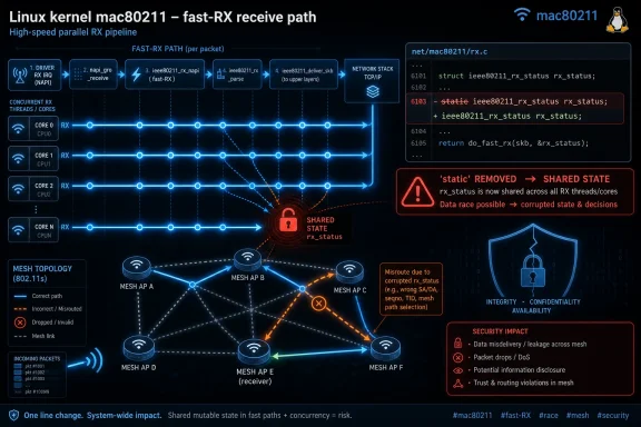

CVE-2026-46152 is a Linux kernel Wi-Fi vulnerability published by NVD on May 28, 2026, affecting mac80211 fast-RX handling, where a mistakenly static per-call result variable could be shared by concurrent receive paths and misroute mesh packets. The patch is almost comically small: delete one keyword, change the storage lifetime of one variable, and the race disappears. But the lesson is larger than the diff. Modern wireless stacks are now so parallel, optimized, and feature-dense that a single stray static can turn a fast path into a correctness bug with security implications.
The One-Word Kernel Bug That Says More Than It Should​
The Linux kernel has a long tradition of security fixes that look underwhelming in code review and unsettling in production. CVE-2026-46152 belongs to that lineage. The change is not a new bounds check, a redesigned parser, or a mitigation around hostile firmware; it is the removal of static from a local variable in ieee80211_invoke_fast_rx().
That matters because static is not just decoration in C. A function-local static variable is allocated once and shared across calls, rather than created anew for each invocation. In single-threaded code, that can be harmless or intentional. In a hot receive path that is documented as safe for parallel RX, it is the kind of state leak that kernel developers spend decades learning to fear.
The affected path sits in mac80211, the kernel’s common 802.11 wireless subsystem used by many Linux Wi-Fi drivers. This is not a boutique corner of the stack. mac80211 is part of the plumbing that lets Linux laptops, access points, embedded devices, and test rigs speak Wi-Fi without every driver reimplementing the whole protocol machine.
The vulnerability description is narrow: concurrent callers could overwrite each other’s rx_result between mesh data handling and a later switch on that result. The consequences named by the patch are packet-flow confusion: a packet already queued or consumed could fall through into ieee80211_rx_8023(), or a packet meant to continue could instead be treated as queued. That is not a remote-code-execution headline. It is, however, a warning about trust boundaries inside a kernel path that processes packets arriving over the air.

The Patch Is Tiny Because the Invariant Was Huge​
The actual code change is one line: static ieee80211_rx_result res; becomes ieee80211_rx_result res;. The former creates one shared instance. The latter creates an automatic variable for each call. In ordinary user-space programming, this is a teaching example; in the kernel, it is a race condition hiding in plain sight.
The key invariant is that each invocation of ieee80211_invoke_fast_rx() must carry its own receive result from the mesh handling step to the subsequent decision point. Once that result can be overwritten by another CPU or concurrent receive context, the function is no longer reasoning about its own packet. It may be reasoning about a neighbor’s packet.
That is especially pernicious because it does not require memory corruption in the classic sense. No buffer needs to overflow. No pointer must be smashed. The bug is semantic corruption: the program’s control flow follows a valid value that belongs to the wrong invocation.
