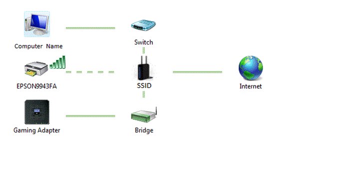

I have been changing my settings to try to make my devices revert to basic, but have not found a setting. Mine do show the IP address and MAC address and allow access to the configuration utility.
It seems devices that can offer the information you are seeking have to offer WiFi Protected Setup. It does not appear it needs to be enabled, but it seems that is part of the capabilities needed. If yours is disabled, you might try enabling it to check.
If you reset your router and any firmware updates were rolled back, you might check to see if an update is available.
And lastly, on my map (attached) the switch on the top was showing as a question mark until I disabled IPv6. After doing that, it showed as a switch. I could then re-enable IPv6 and it stayed.
So, try going to your network adapter settings (ncpa.cpl) and properties and uncheck IPv6. You may need to disable the adapter, then re-enable to get it to rescan. Once that is done you can reverse the process and re-enable IPv6.
