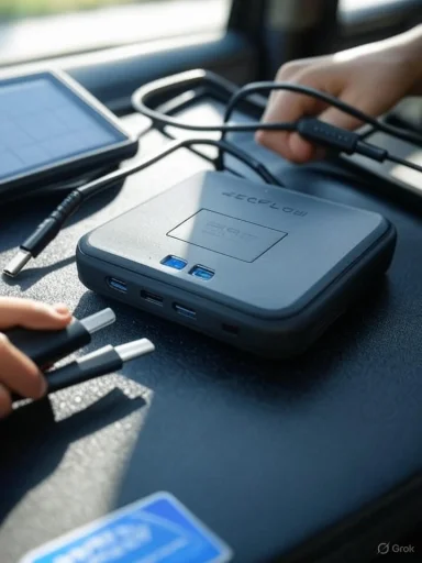

A compact multi-port power bank on a car dashboard with built-in USB cables.Background / Overview​
The EcoFlow TRAIL 300 DC is a new entrant aimed squarely at people who want meaningful capacity in the smallest possible package. The unit packs 288 Wh (marketed as 90,000 mAh) into a LiFePO4 (LFP) chemistry pack, weighs roughly 2.58 kg / 5.7 lb, and delivers up to 300 W total output via a handful of DC ports: two high‑power USB‑C PD ports rated at 140 W (in/out) each, two USB‑A ports (12 W each), and a 12 V car outlet. It deliberately omits an AC inverter to cut weight and increase efficiency.
That combination — LFP chemistry, compact form factor, 140 W PD ports, and a sub‑6 lb chassis — is what makes the TRAIL 300 notable for travel. In testing reported by ZDNET, the device repeatedly refreshed tablets and phones for a family on the go and proved popular with kids who could carry it without being weighed down. The review emphasized its portability, strong PD output, and surprisingly quick recharge times. (The ZDNET hands‑on is the practical test that kicked off this piece.)
