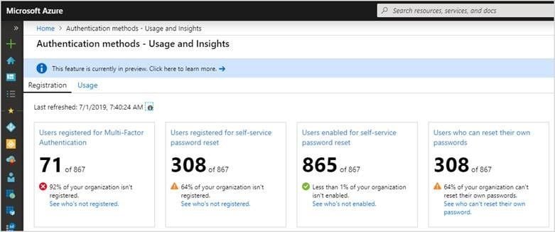

Microsoft’s recommended admin path is straightforward: review SSPR coverage in the Microsoft Entra admin center, then inspect user registration details under Authentication methods. The goal is to confirm that each user has at least one registered method satisfying the organization’s SSPR policy.
That sounds simple, but the politics of cleanup can be harder than the technical task. Some users will ignore prompts. Some will not understand why a phone number that “already works” must be registered again. Some will be unable to complete registration because they are rarely interactive, work in constrained environments, or use shared operational accounts that should probably be redesigned rather than patched.
Admins should treat this as a staged campaign, not a September surprise. Identify users who rely on directory-sourced attributes. Communicate the change in plain language. Give help desks scripts that distinguish between registering a recovery method and updating a profile phone number. Track completion before enforcement, not after.
The important metric is not whether SSPR is enabled. It is whether the user population has registered methods that satisfy the actual reset policy. Those are different questions, and September will punish organizations that confuse them.

That leaves admins with a short, specific action list:
  • Organizations should identify users whose SSPR access depends on unregistered directory contact attributes before the July 6, 2026 prompting phase begins.
  • Every SSPR-enabled user should have at least one registered authentication method that satisfies the tenant’s password reset policy before September 7, 2026.
  • Privileged accounts should be audited first because reset failures or weak recovery methods carry higher operational and security risk.
  • Help desks should be prepared to explain the difference between updating profile contact information and registering a trusted authentication method.
  • Hybrid environments should test password reset flows end to end, including password writeback and Windows sign-in consequences where applicable.
  • Admins should use the deadline as a chance to remove stale recovery data rather than merely convert old assumptions into new registrations.

The 86 Percent Figure Is Comforting Until You Own the Other 14 Percent​
Microsoft says about 86 percent of SSPR verifications already use registered methods. That is the kind of statistic vendors like because it frames the change as low-impact modernization rather than a disruption. For many tenants, that will be true: users with Microsoft Authenticator, SMS, voice, email OTP, or other approved methods already registered may never notice the policy shift.
But identity incidents rarely emerge from the median user. They come from the contractor with an old phone number, the executive assistant whose alternate email was inherited from a predecessor process, the shared operational account someone should have retired, or the hybrid user whose contact attributes arrived from on-premises Active Directory and were assumed to be “good enough.” The 14 percent is where the support tickets live.
For a 500-user organization, 14 percent is 70 people. For a 50,000-user enterprise, it is 7,000 users. Even if Microsoft’s global number does not map neatly onto any one tenant, the arithmetic should make administrators cautious about treating this as a footnote.
The practical risk is not that Entra ID suddenly breaks password reset for everyone. The risk is that a subset of users discovers the new rule only when they are locked out, under time pressure, and unable to satisfy recovery. At that point, the identity hardening benefit is real, but so is the service desk escalation.

For IT teams, the work starts with visibility. A tenant that cannot quickly answer who is registered for SSPR, which methods they have, and whether those methods satisfy current policy is not ready for September. The same is true for organizations that require two methods but have large groups with only one valid method enrolled.
Microsoft’s own SSPR model allows administrators to configure whether one or two methods are required for reset. That choice matters more under the new rule because the reset flow will be less forgiving of unregistered fallback data. If a user needs two methods and only one approved method is registered, they may be unable to complete recovery even if the directory contains other contact fields.
There is also an admin-account angle. Accounts with privileged roles already face stricter reset expectations, and they should. But the more interesting risk may be semi-privileged operational users: help desk staff, billing admins, device administrators, automation owners, and application support personnel. These accounts often sit below the executive visibility line while still holding enough access to matter.
A responsible remediation plan should not simply chase everyone equally. It should prioritize privileged users, high-risk departments, remote workers, and populations with known enrollment friction. The goal is not just to lift a registration percentage; it is to prevent the wrong accounts from becoming both less recoverable and more operationally urgent on the enforcement date.

  • Tenants should identify users who rely on directory-sourced mobile phone, business phone, or alternate email values that have not been explicitly registered as recovery methods.
  • Administrators should confirm whether their SSPR policy requires one method or two, because users with insufficient registered methods may fail recovery even if other contact data exists.
  • Hybrid identity teams should separate synchronized profile attributes from authentication method registration instead of assuming Entra Connect-populated data is recovery-ready.
  • Support teams should prepare for a short-term rise in manual reset requests around September 7, especially from users who ignore or miss the July registration campaign.
  • Privileged and operationally sensitive accounts should be remediated first, because a locked-out admin is both a productivity problem and a security exception waiting to happen.
  • Organizations should harden manual identity proofing procedures so that stricter self-service reset rules do not push attackers toward the help desk.
The cleanest interpretation of Microsoft’s change is also the most demanding one: recovery is no longer allowed to borrow trust from whatever happens to be in the directory. By September 7, 2026, Entra ID tenants need to make that trust explicit, user by user and method by method. That will create friction for the laggards, but it is the right kind of friction — the kind that forces identity teams to find the difference between a field being filled in and a recovery factor being real.
