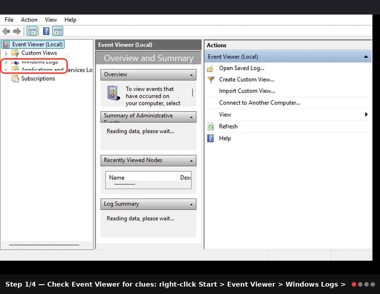

  1. Identify and document the issue
  • Reproduce the problem: note when the sleep/wake issue happens (after a period of inactivity, when waking from lid/opening the laptop, during a particular app, etc..
  • Check Event Viewer for clues: right-click Start > Event Viewer > Windows Logs > System. Look for events around 201-202 (sleep/wake) or warnings/errors close to wake events. Jot down the details to reference if needed.
  • Tip: If you find a consistent error (e.g., “The system process... failed to suspend”), you’ll know where to focus next.
Event Viewer showing the System log for sleep and wake troubleshooting.
