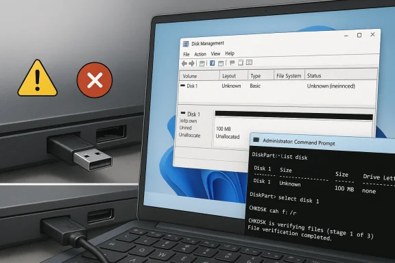

USB drives that vanish in Windows 11 are usually not “mystery failures” so much as a chain of small problems: a bad port, an unhelpful driver state, a missing drive letter, or a file-system issue that keeps the stick from mounting normally. The good news is that Windows still exposes a fairly deep toolkit for diagnosing removable storage, and in many cases you can restore access without replacing the drive. The bad news is that the fix depends on where the failure occurs, so the right first step matters.
Laptop shows Windows Disk Management with errors and a Command Prompt running DiskPart/CHKDSK.Background​

Disk Management and Missing Drive Letters​
When a USB drive is present but invisible in File Explorer, Disk Management often reveals the truth immediately. Microsoft community guidance repeatedly points to the absence of an assigned drive letter as a reason a removable volume stays hidden even though the hardware is detected.
Assigning a letter is often the real fix​
If the stick has a healthy partition but no letter, right-click the volume and assign one. This is one of the simplest and most effective fixes because Explorer only lists mounted volumes with accessible letters. The drive can appear “gone” to users while being perfectly visible to Windows internally.
This is also why enterprise support teams often check Disk Management before they touch drivers. A volume that has no letter is not broken in the same way a dead device is broken; it is simply not exposed to the shell.
What Disk Management can reveal instantly​
Disk Management can show whether Windows thinks the device is online, unallocated, raw, or healthy. Those labels are more useful than the vague “USB not recognized” complaint. They tell you whether the issue is a partition table, a drive letter, or a deeper file system problem.
If the partition appears raw or unallocated, Windows may not have a usable file system to mount. In that case, the fix may be repair or reformatting, not driver work. If the volume appears healthy but lacks a letter, the problem is administrative, not mechanical.

DiskPart and Write Protection​
If the USB drive is not visible in Disk Management, or if it appears but refuses to accept changes, DiskPart becomes the next step. Microsoft’s attributes disk documentation confirms that Windows supports clearing a disk’s read-only flag through DiskPart, which is often relevant when a stick is locked into write-protected mode.
Why DiskPart is useful​
DiskPart sees beyond some of the GUI conveniences and exposes the raw disk object. Running list disk can tell you whether the device is being detected at all, while attributes disk shows whether the disk is marked read-only. That is a crucial distinction when a drive appears but cannot be repaired or formatted.
If the disk is present, you can select it and clear the readonly attribute. In many cases, that is enough to restore write access and allow normal reformatting or volume repair. Microsoft documents attributes disk clear readonly specifically as a supported command.

File-System Repair and CHKDSK​
Once the drive is visible and writable, CHKDSK can repair logical file-system damage. This is particularly relevant when the USB stick appears in Windows but behaves erratically, shows corruption messages, or refuses to open normally. A successful CHKDSK run often means the issue was not hardware failure but a damaged file-system structure.
What CHKDSK can and cannot do​
CHKDSK can fix directory inconsistencies, lost chains, and certain metadata errors. It cannot perform miracles on physically damaged flash memory. If the controller or NAND is failing, CHKDSK may fail, hang, or report that the volume is write-protected. That is why it comes after the read-only check, not before.
The command is often useful when the drive letter exists and the volume is at least partially mountable. Microsoft’s community and support material routinely treat CHKDSK as a follow-on repair after the device is made visible again.
