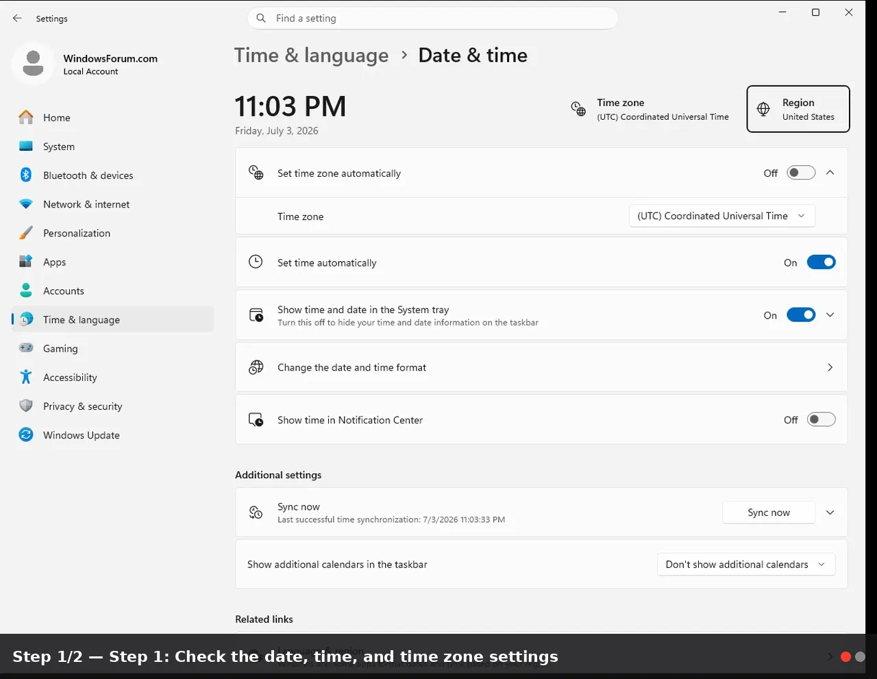

Step 1: Check the date, time, and time zone settings​
Windows 11 Date & time settings with automatic time options and time zone selector visible.
The first thing to verify is that Windows is using the correct time zone and that automatic syncing is enabled.
  • Press Windows + I to open Settings.
  • Go to:
  • Windows 11: Time & language > Date & time
  • Windows 10: Time & Language > Date & time
  • Make sure these options are enabled if available:
  • Set time automatically
  • Set time zone automatically
  • Confirm the Time zone shown matches your region.
If the wrong time zone is selected, your clock may appear wrong even if internet time sync is working properly.
Tip: If automatic time zone detection is incorrect, disable it and manually choose the correct time zone from the drop-down list.
