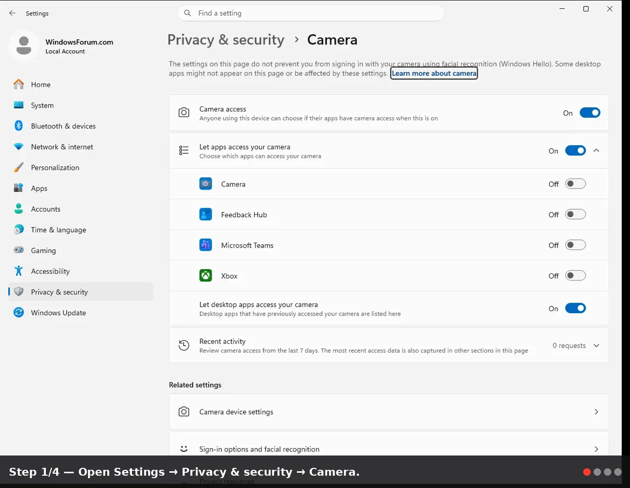

2) Check Windows privacy permissions (most common fix)​
Windows can block camera access at the OS level—even if the camera is working.
Windows 11​
  • Open Settings → Privacy & security → Camera.
  • Turn Camera access On.
  • Turn Let apps access your camera On.
  • Review the app list and ensure your target app (e.g., Teams, Zoom, Discord, browser) is On.
  • Scroll down to Let desktop apps access your camera and turn it On (important for classic apps).
Windows 11 Camera privacy settings with camera access toggles and app permissions.
