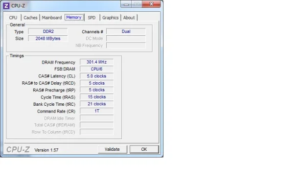

RAMMon v1.0 Build: 1002 built with SysInfo v1.0 Build: 1006
PassMark (R) Software - www.passmark.com
Memory Summary For SC-PC
Number of Memory Devices: 2 Total Physical Memory: 2047 MB (2048 MB) Total Available Physical Memory: 785 MB Memory Load: 61%
ItemModule #1Module #2Ram Type DDR2 DDR2 Standard Name DDR-667 DDR-667 Module Name PC-5300 PC-5300 Memory Capacity (MB) 1024 1024 Bus Clockspeed (Mhz) 333.33 333.33 Jedec Manufacture Name Kingmax Semiconductor Kingmax Semiconductor Search Amazon.com Search! Search! SPD Revision 1.2 1.2 Registered No No ECC No No DIMM Slot # 1 3 Manufactured Year 2000 Year 2000 Module Part # KSCD48F-B8MO5 KSCD48F-B8MO5 Module Revision 0x0 0x0 Module Serial # 0x0 0x0 Module Manufacturing Location 65 65 # of Row Addressing Bits 14 14 # of Column Addressing Bits 10 10 # of Banks 8 8 # of Ranks 1 1 Device Width in Bits 8 8 Bus Width in Bits 64 64 Module Voltage SSTL 1.8V SSTL 1.8V CAS Latencies Supported 3 4 5 3 4 5 Timings @ Max Frequency 5-5-5-15 5-5-5-15 Minimum Clock Cycle Time, tCK (ns) 3.000 3.000 Minimum CAS Latency Time, tAA (ns) 15.000 15.000 Minimum RAS to CAS Delay, tRCD (ns) 15.000 15.000 Minimum Row Precharge Time, tRP (ns) 15.000 15.000 Minimum Active to Precharge Time, tRAS (ns) 45.000 45.000 Minimum Row Active to Row Active Delay, tRRD (ns) 7.500 7.500 Minimum Auto-Refresh to Active/Auto-Refresh Time, tRC (ns) 60.000 60.000 Minimum Auto-Refresh to Active/Auto-Refresh Command Period, tRFC (ns) 127.000 127.000 DDR2 Specific SPD Attributes Data Access Time from Clock, tAC (ns) 0.450 0.450 Clock Cycle Time at Medium CAS Latency (ns) 3.750 3.750 Data Access Time at Medium CAS Latency (ns) 0.500 0.500 Clock Cycle Time at Short CAS Latency (ns) 5.000 5.000 Data Access Time at Short CAS Latency (ns) 0.600 0.600 Maximum Clock Cycle Time (ns) 8.000 8.000 Write Recover Time, tWR (ns) 15.000 15.000 Internal Write to Read Command Delay, tWTR (ns) 7.500 7.500 Internal Read to Precharge Command Delay, tRTP (ns) 7.500 7.500 Address/Command Setup Time Before Clock, tIS (ns) 0.200 0.200 Address/Command Hold Time After Clock, tIH (ns) 0.280 0.280 Data Input Setup Time Before Strobe, tDS (ns) 0.100 0.100 Data Input Hold Time After Strobe, tDH (ns) 0.180 0.180 Maximum Skew Between DQS and DQ Signals (ns) 0.240 0.240 Maximum Read Data hold Skew Factor (ns) 0.220 0.220 PLL Relock Time (ns) 0.000 0.000 DRAM Package Type Planar Planar Burst Lengths Supported 4 8 4 8 Refresh Rate Reduced (7.8us) Reduced (7.8us) # of PLLS on DIMM 0 0 FET Switch External Enable No No Analysis Probe Installed No No Weak Driver Supported Yes Yes 50 Ohm ODT Supported Yes Yes Partial Array Self Refresh Supported No No Module Type SO-DIMM SO-DIMM Module Height (mm) 30.0 30.0

MEMORY_MANAGEMENT (1a)
1. The memory is set wrong, currently 600 Mhz 5-5-5-15 while it's rated 667Mhz 5-5-5-15.

Attach CPU-Z memory tab snapshot, it'll show your current settings.
scr
New Member
#11
here it is with the setup default bios option
#12
600 Mhz at the moment. If you keep getting more crashes, you need to set the memory right. Because updating drivers and reinstalling the system won't help. Ask a PC technician to help you.

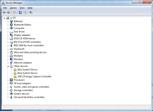

thanks for the great help before, i sent my laptop to the asus service in hungary. they replaced the CPU with a new one. it was working great till this morning when i got another crash recently. the wlan/bluetooth switch was turned on(usually its not). also noticed there are 2 marked entrys in the device manager.
#14
is the memory timing still bad? what is that usb 2.0 video driver? and how can i find a good nforce driver for this notebook? didnt have success last time it seems
#16
It is bad indeed, 600mhz 5-5-5-15. Again, attach this stuff:
1. CPU-Z CPU tab
2. CPU-Z memory tab
