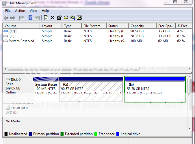

You might open Disk Management, and use the snipping tool to take a picture then attach using the paperclip from an Advanced reply. It might be good to know which partition is active and where your boot files are before you delete a partition. Make sure and label which Win 7 install is which.
Thank you for the replies. Here is the disk mgt snip it.

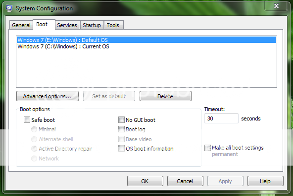

and here is the boot from system config...
It is a little strange you have a logical partition on the drive, did you put it there or Ubuntu?
The System Reserved and C: appear to be a normal Win 7 install. If C: is where the install you want to keep is, Super Sarge's suggestion should work fine.
You can also change the Default OS partition in msconfig, so before you delete a partition, set that to the install you want and make sure it is working. After you do that, look at Disk Management again and make sure the partition you show as C: is the one you think.
If it turns out the E: partition (Logical) is the one you want to keep, that might present a problem in the future.
One determine which OS you want to keep, IF you want to keep your current default as shown which is E just highlight the one with C in it and hit delete button.
If you want to keep the one that says C highlight it and make it your default. Then highlight E and delete it. Upon reboot the machine will boot to the one you choose as a default and since you deleted the other one you will no longer see the machine asking you to make a choice. After that I would go to the drive where the old OS is a delete everything in that drive. Your disc will now have 3 partitions one with System Reserve 100 MB The other one will have you Windows OS on it, the third one will have the old one it. In fact I would rename disk on the one you are going to delete as w7delete, so when you go to remove everything on this old one you know you are on the right disc/partition.

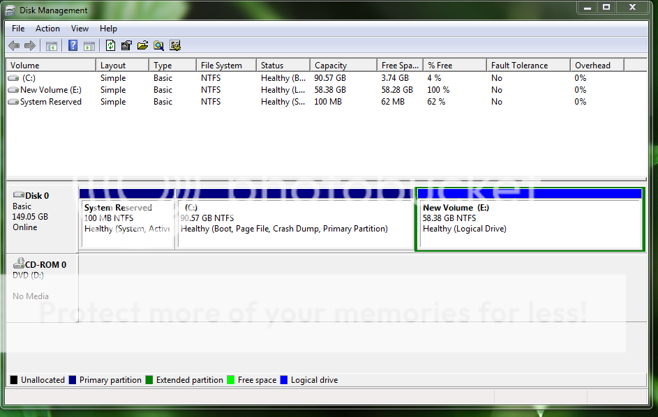

Thank you for your advise. I have follow your steps. Now I have the partition and it has been formatted as NTFS file system. It now says "New Volume (E):". How do i extend C partition to take up all the free space? I was a little confused on that part from your post. Thanks.
Here is a pic of where I am at now:
Okay, I think I have it! Take a look at this updated DM image...
you have it correct, like Mike said you should by at least a 500 gig second internal HD or External, I prefer internals when possible have it installed so you can store all your personal files on the second drive. You can also do full backup image of your C Drive to this Internal/external drive.
I would if I were you change the drive letter on the D drive your DVD/RW drive to something like Z so if you install another drive it will automatically become the D drive.
