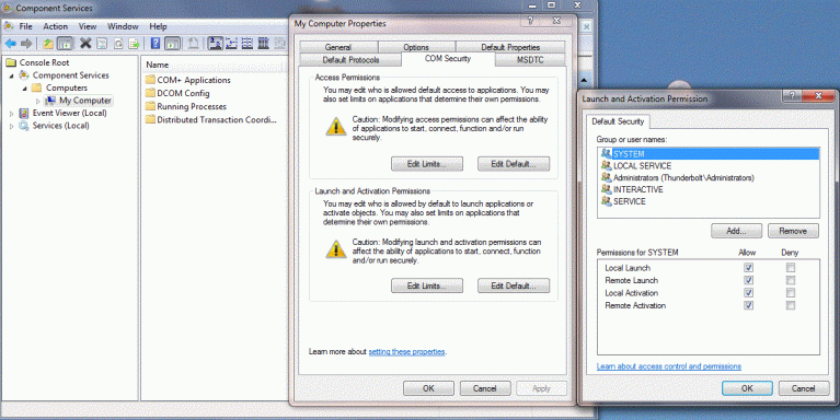

Can anyone tell me what Groups should appear in Component Services for Computer/MyComputer/Properties/Com Security Tab for a new install. I need groups listed and their checked permissions for both panes (Access & Launch/Activation) and both buttons (Limits & Defaults) or point me to documentation that lists (rather than explains) the defaults.
Also require a list of the users that would normally be members of the "Distributed COM Users" localgroup. I had none.

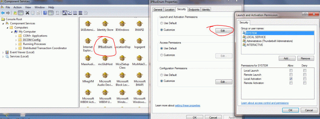

You did not include the GUID numbers for your error messages, but if you copy the entire error message you can find references on the net.
In my case, the 10016 error was caused by the IPBus Enumerator, which was tied to the Wireless Printer. I was able to remove the error messages by making some changes in Component Services, but not the ones mentioned in some posts. I may have done it incorrectly, but I ended up having to change some permissions in the Registry to gain access to make the changes.
The attachments below are not a new install, but one repaired and no longer getting the error messages. As far as I know, these errors were not causing any other problems. But I was only running a printer, and not using Homegroups.
