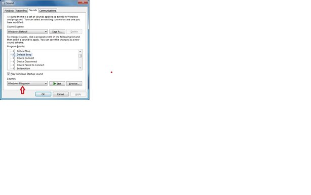

    Currently my computer has no sound Startup and Shutdown at Windows 7, although all other sound systems are operating normally,
    Default Beep caution :rolleyes:
    [​IMG]
    Looking forward to the help, Thanks!

    and your sound card/device is?

    so when you click on the yellow Astrix don't you get options of which sound to use in that selection? you normaly choose one then click apply :eek:

    not overclock, I've used Startup Restore.... but so
    [​IMG]
    After I install the driver again, yellow is not appear, but some new problems appear
    I tried to reinstall the driver many times, but this seems more serious problem ...
    When I starting Windows, It emits a beep several times
    I need a skill can restore the entire Windows system sounds in Registry

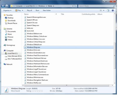

    You don't have the .wav audio file for that event in the C:/Windows/Media/ folder.
    I have included the file in an attachment. Copy it to that folder and the chime should work.
    You are probably missing the startup and shutdown .wav files too.

    These beeps you hear are when Windows starts and not during boot, correct?
    The windows sounds are in the \Windows\Media folder. Changing those files is not easy to do. Are yours still there? Have you been running any other software that might have altered your normal setup?
    Have you tried making any registry changes yourself that might have caused problems. I do not see registry entries for the sounds themselves, just file associations.
    The Windows startup sound is in another file that has to be hacked to change. Were you attempting to do that?
