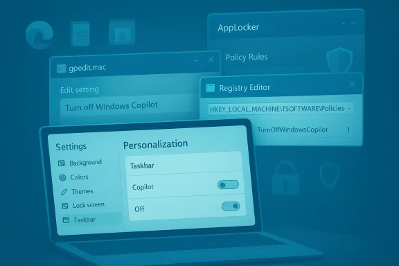

Overlaid Windows settings panels on a laptop, featuring Copilot, Registry Editor, and policy screens.Background / Overview​
