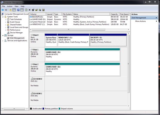

well you would expect around 15-20gig for a typical install of windows 7, especially after all the windows updates and including the swap file. What you may need to do is run the "computer management" tool in admin tools section, have a look at the STORAGE tool within that, then disk management tool to reveal the true structure of way the drive is partitioned. Below is an example using my system, as you see it shows detailed information on how the space is divided up.
As you can see I lost about 69gig formatting and partitioning my 1TB primary HD and about 21gig on each of my 320gig Raided "games" HDs, this is perfectly normal. If your system is showing a RAW or unformatted partition amongst the list then its possible that's somehow been forgotten about or not reclaimed properly when the partition was formatted before install, that being the case you can do it from this tool page on a right click, but be warned dont delete the system or the installation partitions or you'll have to wipe and start over, in addition if the missing space is being used for a system backup then you'll need that in the future to restore to factory defaults assuming it's a windows 7 backup, if it's for an old OS your no longer using then it's okay to format and use provided you never want it again.
