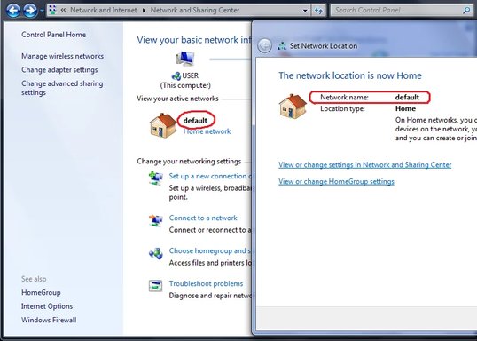

The name of my home group is taken from wifi point. How to change it?
#4
I dont want to configure a network, just change the name of home group (home network) on my computer display. see screenshot.

Open network and sharing center, click on the little house icon on the left next to the words Home Network and default. In the resultant box you should be able to change the word default to whatever you would like it to say
Thank you for the tip. I was searching everywhere, and the solution was simple.
