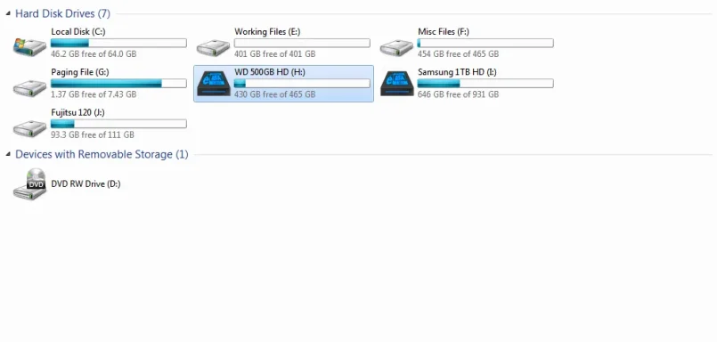

What I do is to leave the D drive as the traditional CD/DVD drive, then I change and arrange the drive lettering after that.
Here is what my system looks like with the two external eSATA drive running also:
Link Removed due to 404 Error
Uploaded with ImageShack.us
I hope this helps.

Robert

OH ROBERT - u have a Sam 1TB and WD500 just like I do - I also have a Hitachi 1TB but that Sam is noticeably faster and the WD is 8-10°C hotter than any of them.
thx
I think you meant Nibiru... LOL! Maybe not?? Yes, the Samsung is a fast hard drive for sure and the WD is 8-10 C hotter too on my system.
