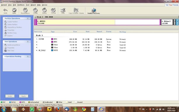

#4
Since it is sometimes hard to see your setup, could you take a snipping tool picture of your Disk Management Windows and attach using the paperclip?
#5
Hi Saltgrass, I hope this is what you meant.
Cheers!

#6
Because you have the system reserved partition, the commands will have to be altered somewhat.
bootsect /nt60 sys /mbr
This one may work by itself, but other commands that were mentioned,
bootrec /fixmbr
bootrec /fixboot
Hit enter after each one and the first one may do the trick, or possibly do the other ones. These can all be run after booting to the Install DVD or Repair CD and going to the command prompt.

#7
bootrec /fixmbr
bootrec /fixboot
If these do not help, let us know.
