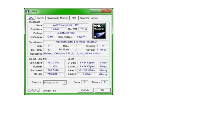

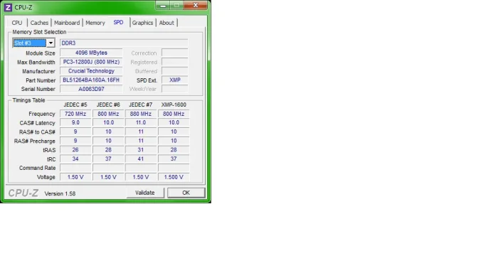

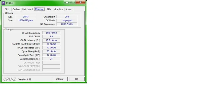

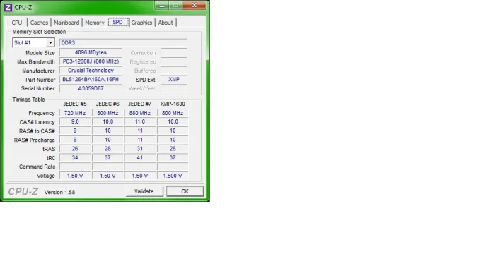

ok here is the cpu-z screenshots

Additionally as to what Elmer was hinting at above it's likely that your current memory configuration needs a slight tweaking.
It seems that on most boards when all memory slots are populated with 1333Mhz memory or higher you will often need a slight increase in voltage to augment the extra demands place on the memory controller.
Having experience something similar myself and having used this link to resolve it, you may want to either check you documentation for your Motherboard or perhaps their specific community support forum for proper instructions. As I am not familiar with your particular board I can't really help except to say that it usually only takes a bump to the next higher integral in your BIOS under memory or DRAM voltage. I wish I could be more specific.

Your memory being Crucial Balistix Ddr3 1600 can you up your ddr voltage 1.65V and see how it goes. If after that you still get bsod's or freezes can you set you command rate to 2.
