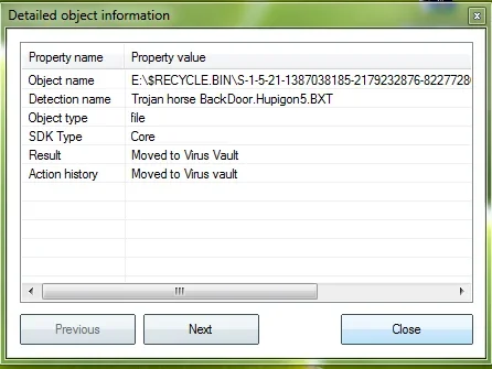

ok their was a virus i have attached file of the virus detail could you tell me if this could be the reason why this blue screen was appearing when downloading?

23000 files scanned and found 165 objects infected what is the internet coming to. their are so many viruses i dont even know the names spyware, malware, rookit and God knows whatelse. lol

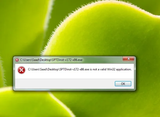

To remove the sptd.sys i installed the duplex software from the link you gave me but it seems their is an error. which i have attached. also I have deleted the file from windows/ system32 file name windrvNT.sys manually. i hope thats ok. currently i have no installed antivirus as i thought i could easly remove the sptd.sys without an antivirus. hope to hear from you soon as you have always helped out quickly for which again I am very thankful

#16
That error screen means that there was corruption when you downloaded the file. Delete it.
Reboot to safe mode + networking. Download it again from there.
Before running it, go to C:\Windows\System32\drivers and make sure sptd.sys is still there.
If it is, run the program to remove it:
DuplexSecure - Downloads
